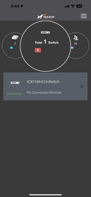

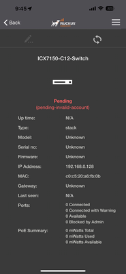

01-10-2023 07:48 AM
I was able to do a software recovery but the unleashed app is showing errors for the switch.
do I need to update the firmware for the switch and if so how is that done?
