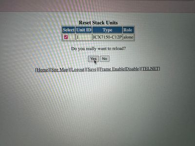

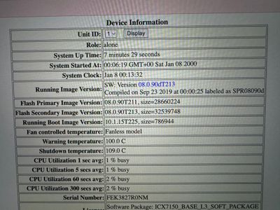

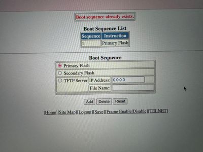

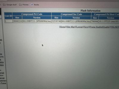

here are some pictures of what I’m seeing.

Hello @AshATexas ,
From the screenshot you shared, I understand that you were able to login to the Switch using the GUI through the web browser.
Please follow the below RUCKUS Lennar Knowledge base self-help article which will help you to fix the issue when the Switch is running in the Routing code through GUI.
Please follow the process as explained in the article and let me know if you have any queries in this regard.
08-22-2024 07:18 AM - edited 08-22-2024 07:20 AM
I went through the steps but it’s still running in spr after the reboot.
08-22-2024 07:47 AM
Okay. Looks like I may have fixed it by switching to secondary flash. Rebooting. Then switching back to primary flash and rebooting.
