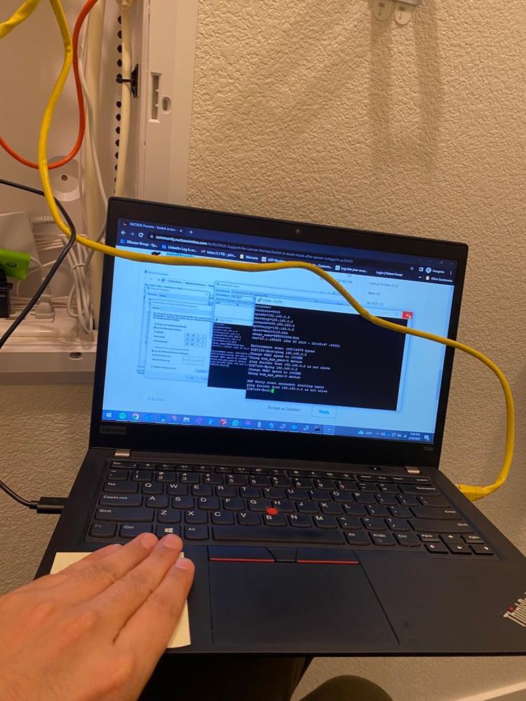

We had a power outage recently after which the AP points do not boot up. I connected my laptop to the Ruckus ICX 7150-C12P Switch via putty but the switch remains in "boot" mode. I tried booting from primary and secondary partition but for both it says corrupted.
So I followed instruction in this link to try and install new image, however now I am stuck at "host 192.168.0.2 is not alive" I set all the required environment variables (as can be seen from the snip below). Please help!
printenv
baudrate=9600
ipaddr=192.168.0.3
serverip=192.168.0.2
netmask=255.255.255.0
gatewayip=192.168.0.2
uboot=mnz10115.bin
image_name=SPR08090d.bin
ver=10.1.15T225 (Jan 30 2019 - 23:08:47 -0800)
Environment size: 189/16379 bytes
ICX7150-Boot>ping 192.168.0.2
Change GMAC speed to 1000MB
Using bcm_xgs_gmac-0 device
ping failed; host 192.168.0.2 is not alive
ICX7150-Boot>
02-27-2023 03:35 PM
Please see attached
02-27-2023 03:40 PM
Hi nimittsarda
Thank you for sharing the requested information and pictures.
Based on the troubleshooting done, and we confirmed after the reset, booting up the Switch, and after trying the software recovery process, the failure persists. This Switch unit Should be RMA (Return Merchandise Authorization) in simple words replacing it.

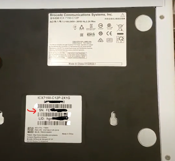

Imran RMA support case is asking for the serial number, I am not sure how to get that. Can you please help?
02-27-2023 04:07 PM
Hi nimittsarda
You could find the Serial Number of the Switch at back of the Switch Unit (As shown in the below screenshot)
