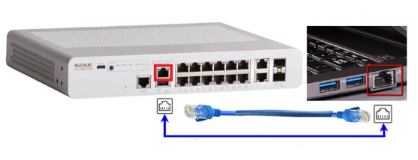

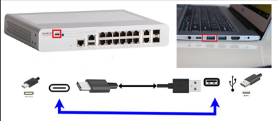

Hi nimittsarda
Could you please provide an image/photo of where you are trying to connect via console / Ethernet from ICX 7150 - C12 P (USB type C to USB ) to the PC. (Physical setup)? like the following example:
