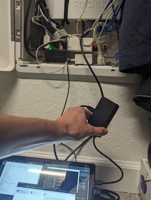

Here everything I did, with pictures. I connected to the switch by Ethernet (via a USB-C dongle) and by the switch's USB-C. Here's a photo of those connections:

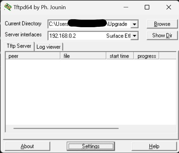

And then I set up the software. I downloaded Putty and tftp64, and here are the settings:
No matter what I did the third entry space for "Default gateway" never remained populated after hitting OK, then reopening the IPv4 settings.

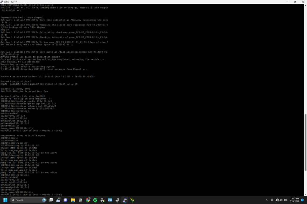

I must've done at least that much right because PuTTY was able to connect to the switch console. And after it did another reboot cycle I caught the prompt to enter boot mode. Here are all the screenshots of my time in the console:
4
3
2
1
You can see I struggled in the beginning while it loaded into the Switch mode, but once I got it in boot mode I was able to set all of the environment variable to the IP addresses I had set elsewhere. However, the switch was never able to make a connection, giving me the "is not alive" message over and over (I did type the wrong IP a couple times, but caught it and used the correct IP for the rest of the time). I tried restarting tftp64 and triple checked my numbers, you can see my settings are correct.
