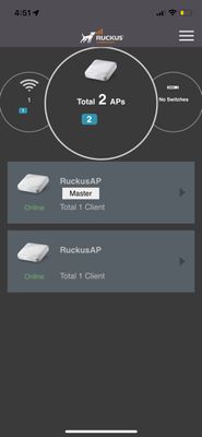

Hello I am a Lennar Home customer and after a power outage my Ap’s refuse to connect to the internet from the switch. They power up fine and broadcast Wi-Fi but no internet. I tried using an old AirPort Express I have from the switch no dice. Then I used an old switch I had from a previous home and it working just fine now. As I believe we have lifetime warranty on our hardware I would like a replacement switch so I can continue to use my AP’s in our ceiling.

Hi @Mhannah513
The web interface you are trying is of Unleashed. We need to access Switch IP on the Web browser or CLI to fix the Routing code issue.
Could you please the check above highlighted IP in the screenshot which might be a Switch IP?
Try to access your switch from a web browser to fix routing code issue (by Web option) by pasting the below URL in http or https form whichever that works.
https://192.168.1.48  or http://192.168.1.48
Or try to access your Switch with CLI as described in the earlier post of the Routing code issue.
