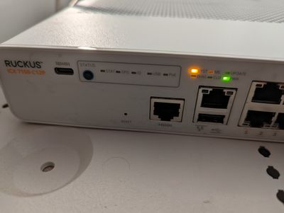

As I can see from the picture you shared, there is an amber/orange light on the "SYST" and a green light on the "PWR" on the Switch. Meaning the Switch is stuck in the boot mode.
Basically, due to the power outage/ power spike, the switch went to a state that we call ‘boot mode’ that is not able to boot up properly.
First, we will try to reset the Switch as described below:
  • Remove power from the switch.
  • Press and hold the Reset button while applying power to the switch.
  • After all the system LEDs flash amber, release the Reset button.
Please let us know once you finish this process. So that we could assist you in upgrading your Switch to the latest stable version to avoid these issues in the future.

Please try to reset the Switch once again with a paper clip.
If still reset is not working, please perform the Software recovery process as described in the previous post.
We have tried to create the guides as non-technical as possible and step by step, so that they are not much difficult to follow. We request to perform the Software recovery of the Switch as per the guide.

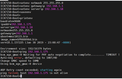

Attached are the 2 errors I encountered.
