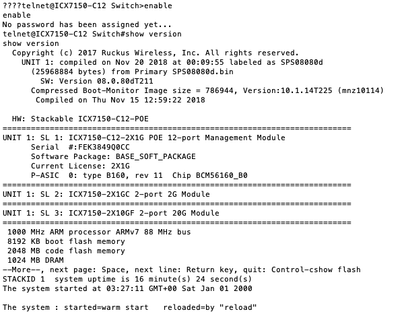

show version

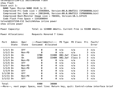

show flash
show inline power

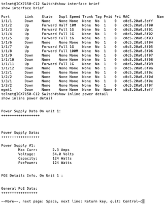

show interface brief
show inline power detail
Hi @apgSM
As your Switch is on the old UFI version 08080d (Please refer to the below screenshot) we suggest you Upgrading your Switch to a latest stable version to avoid this issue.
Please follow to the below steps explaining the Upgrade process.
The recommended stable versions is 8095g (08.0.95g)
The Upgrade path would be: 08080d (your current version)>>8080f>>8095g
(PLEASE NOTE: Use 08095g patch in place of 8095h as explained in the guide)
