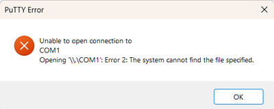

It took me through a different process with that one. Now when I push start and open Putty, I see this:
Can you please tell me what to do next?
Hi @ashleedif
Thank you for your response.
You need to download the Switch drivers and select COM port details from Device Manager. Please refer to the Console article for a detailed, step-by-step guide on obtaining Console access.

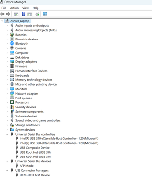

Respectfully, that Console article is far from a detailed step-by-step guide. I downloaded both Putty and the Windows Drivers (including by extracting all files). Now, I have linked my computer and the Switch using a USB type A to type C port. My Device Manager does not show any details for the connection. Instead, this is what it shows while my computer and Switch are connected (it looks the same when they are not connected):

Hi @ashleedif
Could you please disconnect the USB Type-C cable, then reconnect it to the laptop? After doing so, check if the Ports (COM & LPT) section appears in the Device Manager, as shown in the screenshot below.
Please make sure to download the zip drive for the file below & "extract all". Once it's extracted, run the file,  driver should be installed.

If the issue persists, please unplug the USB-C cable and connect the Ethernet cable to the alternate console cable port. Then, check if the COM port details appear in the Device Manager. Please refer to the provided screenshots.
Please let me know if these steps resolve the issue.
