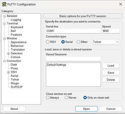

08-05-2024 10:28 AM
It took me through a different process with that one. Now when I push start and open Putty, I see this:
Can you please tell me what to do next?

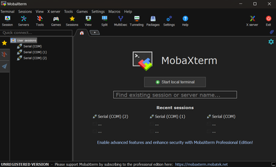

08-05-2024 11:49 AM
Respectfully, that Console article is far from a detailed step-by-step guide. I downloaded both Putty and the Windows Drivers (including by extracting all files). Now, I have linked my computer and the Switch using a USB type A to type C port. My Device Manager does not show any details for the connection. Instead, this is what it shows while my computer and Switch are connected (it looks the same when they are not connected):
Here is what MobaXterm looks like while my computer and Switch are connected by cables (it looks the same when they're not connected):
And this is what Putty looks like while my computer and Switch are connected by cables (it looks the same when they're not connected):
Could you please give very detailed instructions of what to do next?
