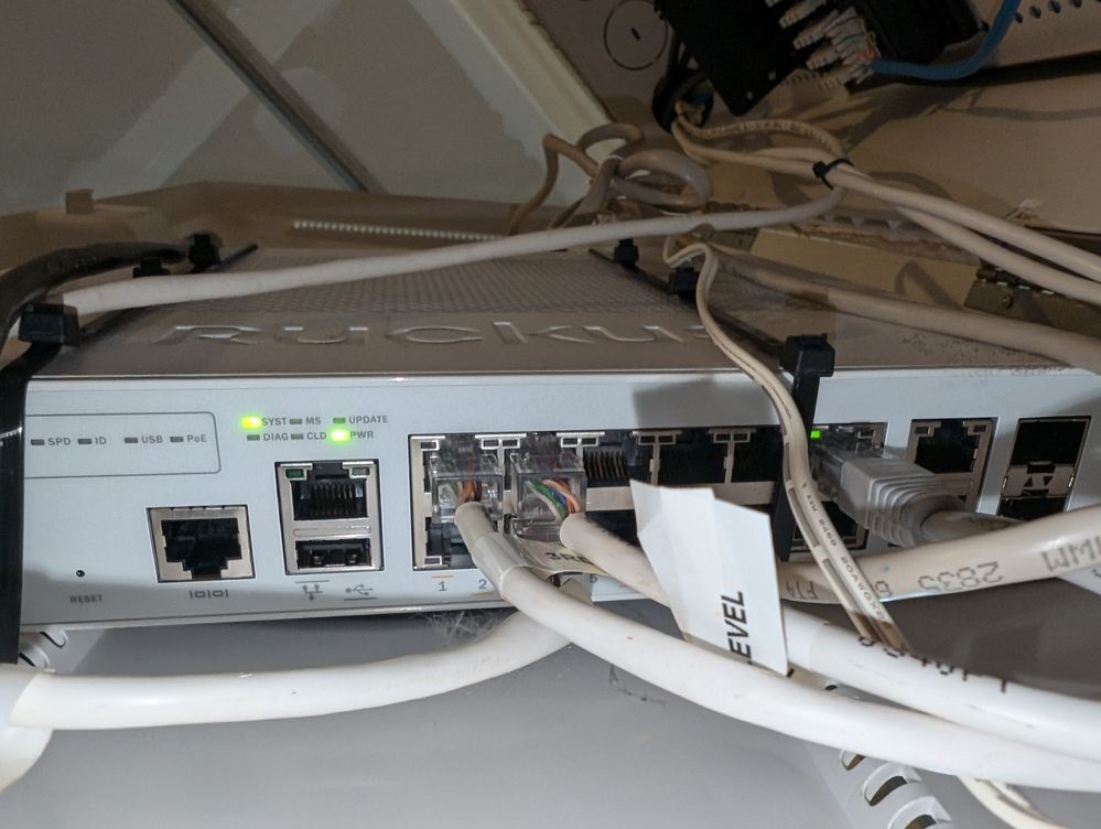

Lennar home user. Never had any issues with my switch and access points for five years. Appears switch is suddenly failing. Ports will power off after a couple minutes every time I try to reboot. The switch box is also pretty hot. I think its.dying. help!!!!

1) On your switch while it's plugged into the outlet, do you see any lights on? (Amber or green) Please let us know which lights are on. (Please refer to the below picture and share a picture of the same, showing the light status and the FULL Switch panel cable connections to the Switch ports)

Hi Pinky - Attached are the pictures. The cord connected to the router is green, ethernet cord going to the smart things box is yellow, and the three access ports are not lit up.  The ports will light up for a few minutes, sometimes even longer, and then inevitably go out. PXL_20240724_212909359.jpgPXL_20240724_212915522.jpgPXL_20240724_212920441.jpgPXL_20240724_212925830.jpgPXL_20240724_212929409.jpg

From the picture you shared, I see the light status and connections of your RUCKUS ICX-7150-C12P Switch are in a normal state.

Hi Imran —  I respectfully disagree that "light status and connections of your RUCKUS ICX-7150-C12P Switch are in a normal state."
None of the three (3) port lights are on and green like they should be in a normal state. All three ports are connected yet there is no light or power going to them.  I don't believe it's a setting issue as it works perfectly fine intermittently and then shuts off.  They will be green for a few minutes and then power off randomly.  Sometimes they stay green and work for about an hour and then shut off.

I was referring to the SYST and PWR lights, not the port lights.
