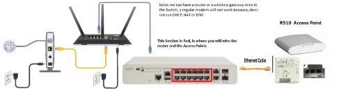

1. On your switch while it's plugged into the outlet, do you see any lights on? (Amber or green) Please let us know which lights are on. (Please refer to the below picture and share a picture of the same showing the light status and the cable connections to the Switch)
2. Is your Internet Connection from the Internet Service Provider (ISP) stable and working? (You could check this by connecting to your local router Wi-Fi or from an ethernet cable from Router to a laptop/PC).
3. May I know how many Access Points are connected to the Switch? Could you please let me know the light status on the Access Points? Any of these lights are on (Please refer to the below picture and share a picture of the same)
Imran_ruckus_1-1685491907832.pngPlease help us with pictures of your ICX-7150-C12P Switch showing the status of the lights. Also, light the status of Access Points.

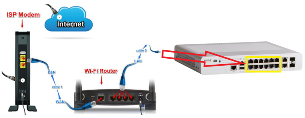

Imran_ruckus_3-1685491907847.pngPlease note that, if your ISP modem is directly connected to the ICX-7150-C12P Switch, it doesn’t work only with Modem. The connection must be from a Router or Modem-Router combo device. Could you please confirm this once?
Please refer to the short guide link below about how to connect the devices as a reference:
