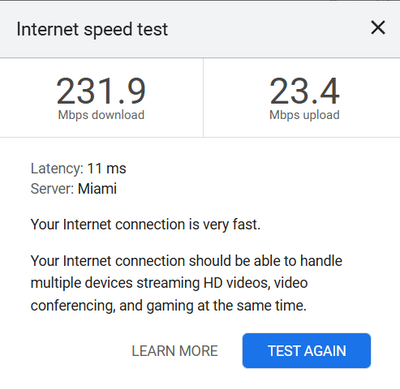

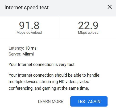

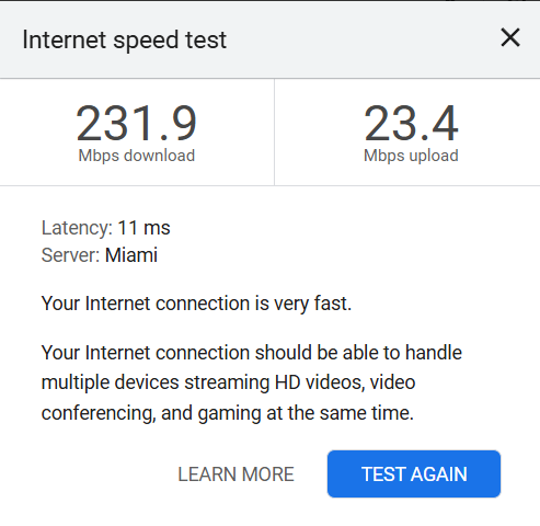

I just upgraded to the latest version and for a day I was getting the correct speed. AGAIN, I cant break 100mb/s on my downstream. I have 200mb/s
This is when connected to Ruckus
This is when connected to xfinity router
Why is the Ruckus so much slower? It like crippling the speed and I dont know why.

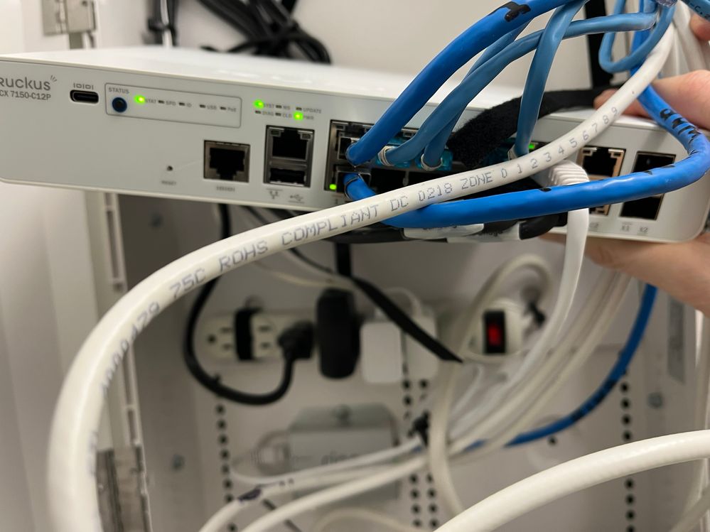

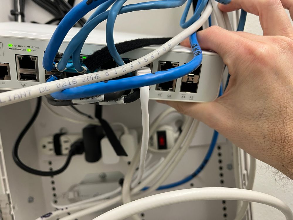

The unit has been operational but the speeds have always seem crippled. After I did the upgrade the speeds were fine for a day and then it drops back down to what the screenshots in the previous post show. I have take a picture but it is hard to see. All the lights are Green.

Hi @dtsteinb
As per the light status of the RUCKUS ICX-7150-C12P Switch, it is in a normal state.
