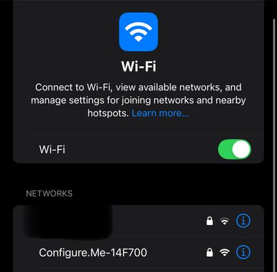

Also, the video you linked said there would be no password needed for the configure me network, but there is on my device
Hi @MrTners
Thank you once again for your response and the update.
If configure.me-xxxxxx prompts for a password, please try entering the Serial Number of the Access Point, which can be found on the rear sticker of the device.
If that does not work, we recommend using a web browser on your laptop to connect to configure.me and proceed with the factory reset process.
For your reference, here is a video guide:
Please let us know how it goes or if you need further assistance.
Hi Imran,
That password did not work, and neither does the admin password. This is the same on my PC as well. Also, the network disappears from the list in under a minute. It seems that this path does not work. How should I proceed?
Hi @MrTners
Please try connecting to configure.me-xxxxxx on your laptop immediately after pressing and releasing the reset button on the Access Point. If there is any delay, the configure.me network may disappear before the connection is established.
Kindly give it a try and let me know how it goes.
Hi Imran,
I cannot connect because the password does not work.
