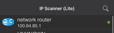

I also downloaded an IP scanner on my iPhone where the results came back with this:
does this help at all?
