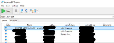

Could you please try restarting the ceiling-mounted RUCKUS Access Point by powering it off and then turning it back on from the power source?
Once restarted, perform an IP scan again and check if an IP address is now assigned to the RUCKUS Access Point in the IP Scan results.
Please let me know the results.
07-15-2025 02:29 PM
Hi Imran,
I just restarted and re-scanned through the IP scanner, but there is still nothing being shown with a Ruckus manufacturer tag:

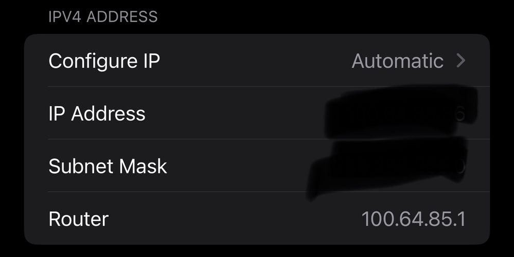

I can see the below within my WIFI settings in the iPhone. Unsure if this is helpful:
Thank you
