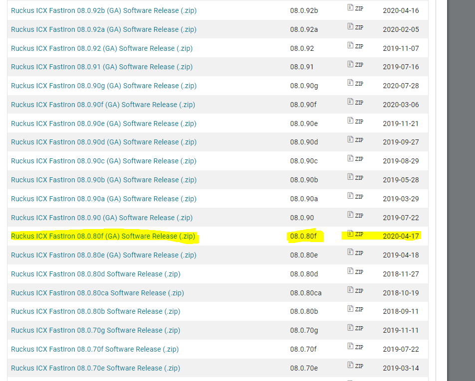

I will first update to
'Ruckus ICX FastIron 08.0.80f (GA) Software Release" 08.0.80f release date 2020-04-17 and then to
"Ruckus ICX FastIron 08.0.95g (GA) Software Release" 08.0.95g release date 2022-05-19

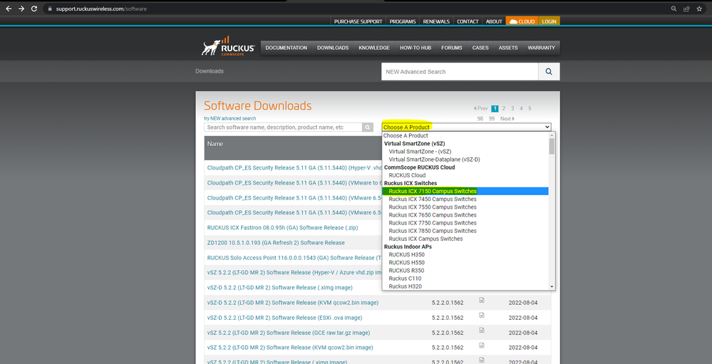

1- Go to Ruckus support page to download the images
Link: https://support.ruckuswireless.com/software

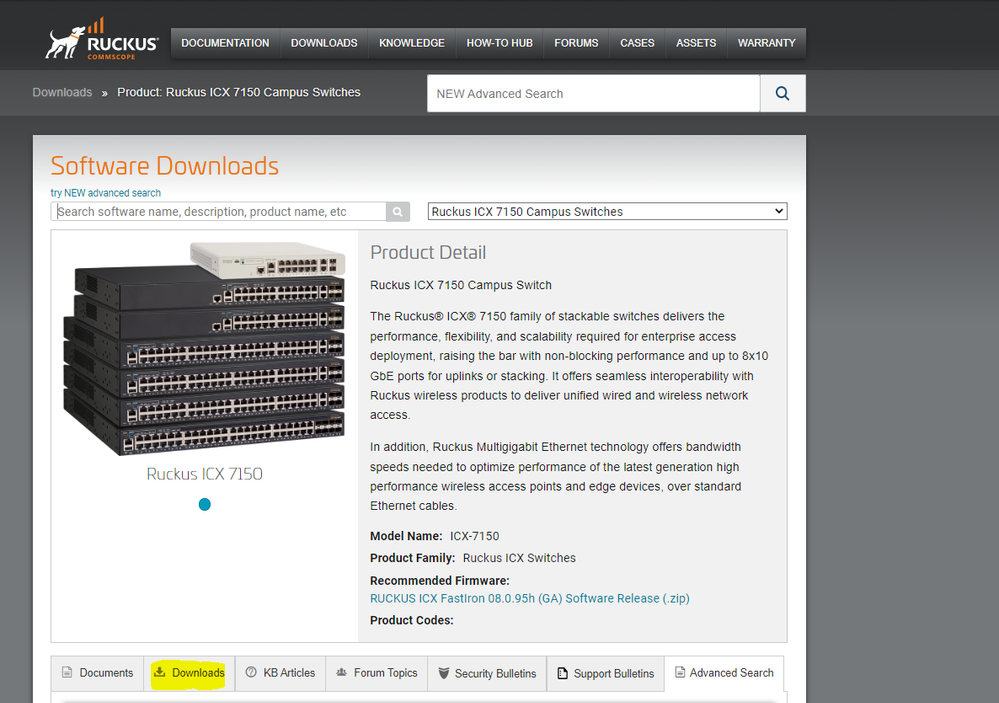

2-Look for the scroll bar,  (Choose Product) where we have to select our product or platform that is an ICX-ICX7150
3-Then click downloads.
4-As mentioned, we are going to go from a non UFI version to a UFI version, so we must go through the 8080f version as intermediate version.

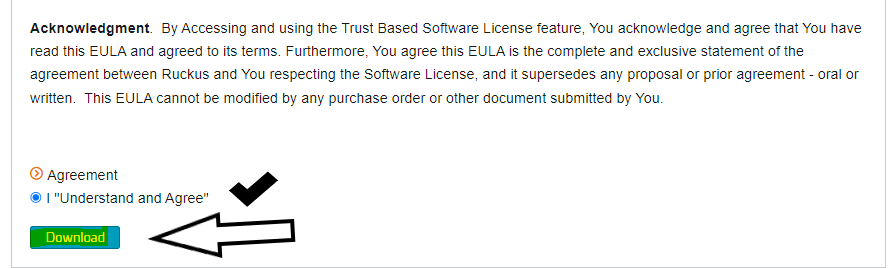

Important note:  Read terms and conditions once this is done proceed to download
Once it is done please follow the below link to proceed the step '6'.
