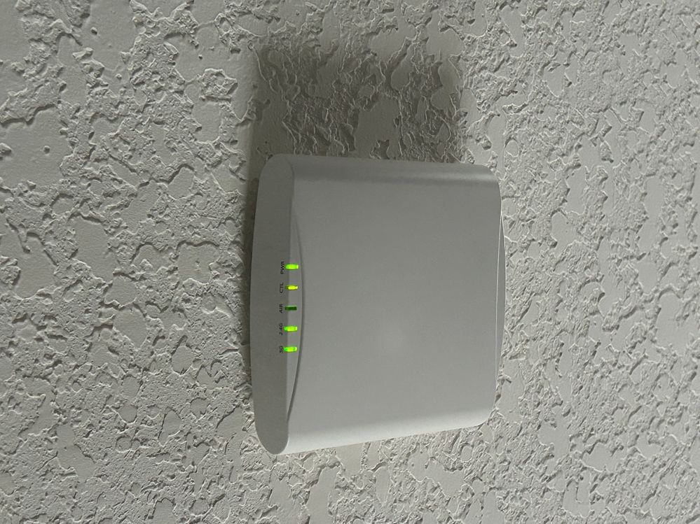

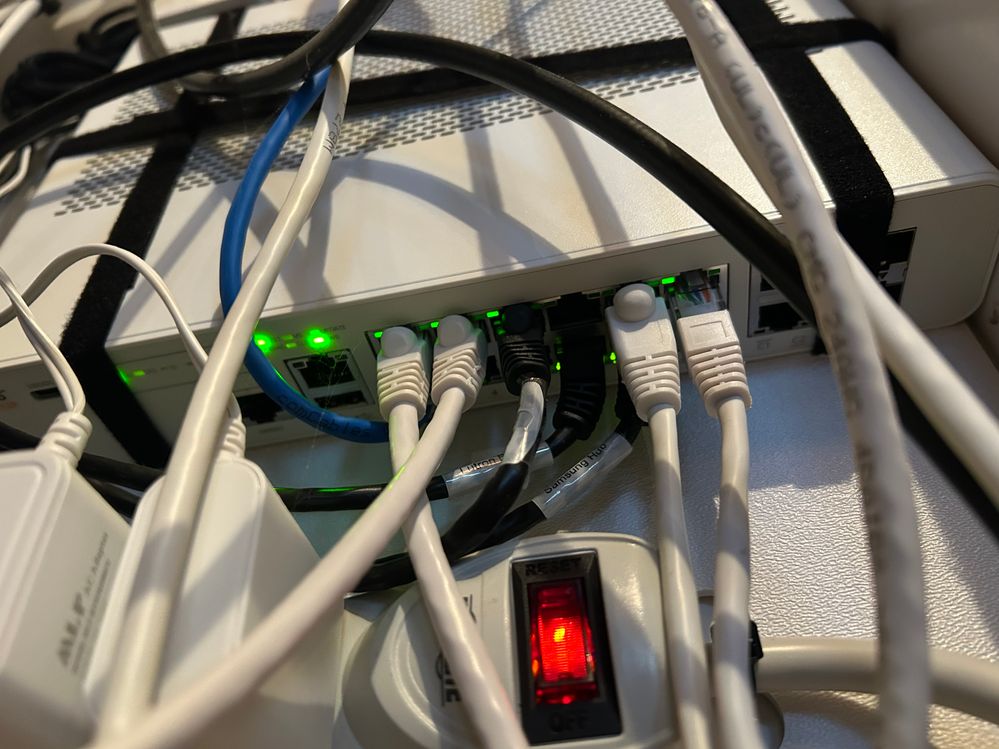

4. How many access points are currently connected to the switch? Please describe the status of the lights on the access points. Similarly, include a photo showing the access points' light status.

2. all green lights - photo attached

4. 2 access points in the house. 1 on main level, 1 upstairs. ruckus box is in the basement. On main level the PWR, 2.4G and 5G lights are green, on the upstairs PWR, 24G, 5G and CTL are green

Hi @hahn0122
As per the pictures you shared, the cable connections and the light status are in a normal state.
Please rearrange the Ethernet cables for the Access Points and the ISP Router by moving them from their current switch ports to any other available ports within the 1–12 range (refer to the screenshot below). Once completed, please test the speeds again.
