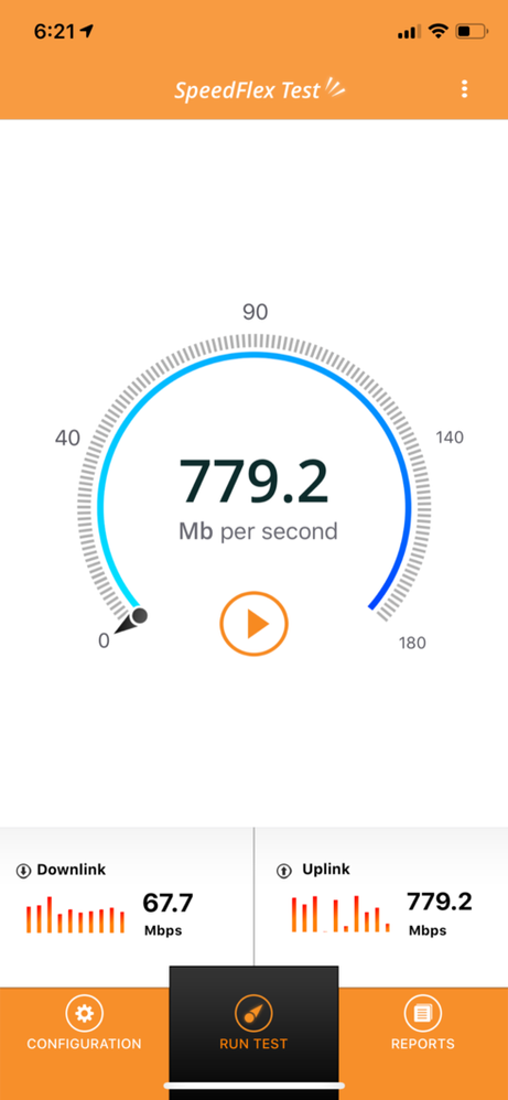

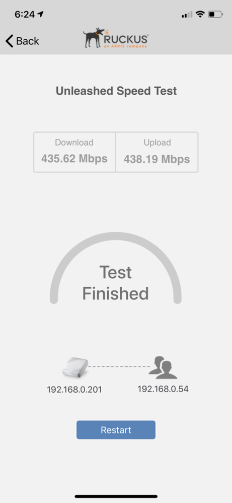

I get totally different results using the freestanding SpeedFlex mobile app vs the test built into Unleashed. Neither SpeedFlex test required an internet connection, but the freestanding SpeedFlex app matches what I get from a single connection on Speedtest with a gigabit up/down connection.Image_ images_messages_5f91c47f135b77e247abc907_4500fedc72f44f3e86f3264c65bf6d79_RackMultipart20200222501741bm7-b353710c-aa87-4779-bfc4-3a8499a8b27d-1503152953.png1582398534
Image_ images_messages_5f91c47f135b77e247abcb70_3a9b4cd1c13c507ba2ca2eedbd0f0810_RackMultipart20200222109329ia4-6c9b1e4a-2a6c-4fe6-a871-358dacc2f132-1473517458.png1582398659
