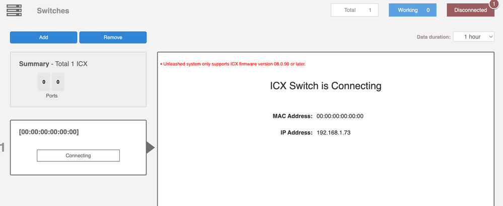

The unleased is not connecting to my ICX-7150 and shows this screen. This is after I upgraded the firmware from 08.0.70 to 08.0.95g
Here are some additional information
1. I have changed the super user password and I am able to telnet as well as login to the switch using the ip address so credentials don't seem to be an issue
2. Both primary and secondary flash reflect the new firmware
Question, do I need to do another factory reset for unleashed to automatically have the switch join and unleashed take over and change the credentials for the switch to reflect the unleasehed credentials? Would a factory reset also revert back my firmware? If these is an alternate solution then let me know.

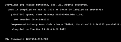

02-12-2024 06:45 AM
Hi @sanjiva_srivast
Could you please access the ICX run the command show version and share the output with me?
ICX7150-C12 Switch>
ICX7150-12P Switch>enable
ICX7150-12P Switch#show version
Kind regards,
Sofia Gätjens

Hi @sanjiva_srivast
Would you kindly inform me of the contents of the text highlighted in red in the ICX screenshot?
Kind regards,
Sofia Gätjens
