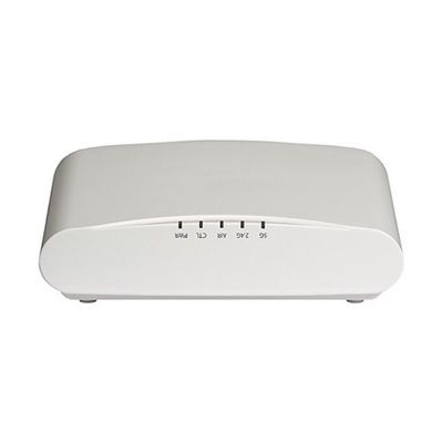

We have two rukus devices and one of them is only showing three lights lit up and we are getting low signals on our ring devices and our TV tends to freeze and isn’t getting good signal. We set up our devices when we moved in however it seems that the rukus device isn’t working as it should. The three dots that are lit up on the device in question are 5G, 2.4G, and power. Air and CTR are not lit up or flashing green. Any help would be much appreciated.

Basically, for Lennar home users the 'AIR' light may be off as the access points  ( white box on the ceiling ) are wired (connected via ethernet cable through a switch that powers on and provides connectivity (ICX 7150-c12p).
And the CTL/DIR light may light on one of the wireless access points ( white box on the ceiling ) , which indicates that it is the ‘main controller of the wireless network’, so it is normal to see that the rest of the access points have no lights on CTL/ DIR.
I will include the LED light guide:
