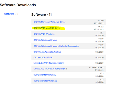

I will add the console Access to the switch ICX-7150 ( white box in your closet ) using a Mac computer to the existing  guide:
1-First at all you need to install the drivers to read the cable type C to console the switch in your Mac computer.
Software:
https://www.silabs.com/developers/usb-to-uart-bridge-vcp-drivers?tab=downloads
https://support.ruckuswireless.com/software/1413-brocade-ruckus-7150-usb-serial-driver-mac
2-After successfully installing the Mac Drivers, open the Mac terminal, when you see the command prompt do the following:
