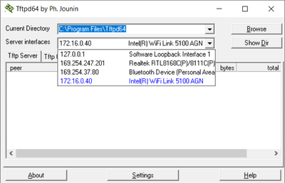

How do i change the server interface on the TFTP by ph.Jounin? I have downloaded it and it is in my computer….what do i need to do?

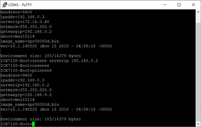

Could you please let me know if you can perform setenv IP addresses?
Thank you.
Yes I can here is the current printenv.
I may have it figured out. I needed to have the tftp open on screen. It’s been doing a lot of configuring
