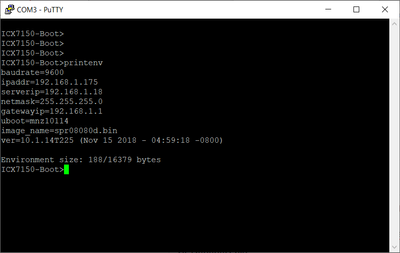

Thats what i did. with the exception of the Image_name which when I do printenv i get  SPR08080D.bin
Hi @sckoshe
As you have used different IP Addresses, please refer to the guide and screenshot below and configure the same.
Please check and let me know.

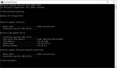

So my network is not based on 192.168.1.1. My network LAN setting is 172.16.0.1. Does that make a difference? Also how do I get the IP address for the TFTP server which is the computer I’m using with PUTTY? Do I use IP config at a command line for the computer?
