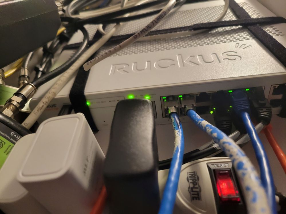

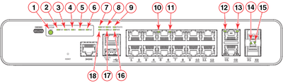

Figure 1. Port-side LEDs of ICX 7150-C12P

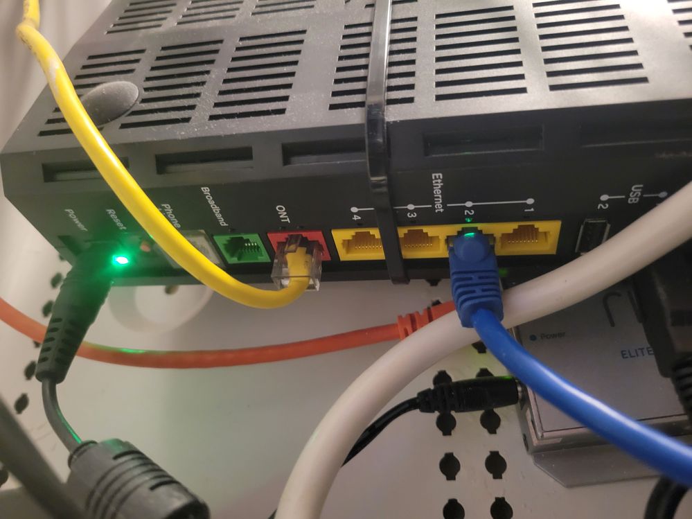

cables with white paint are aps, dark blue cable is att gateway, other eth cables are devices (camera, doorlock, etc)

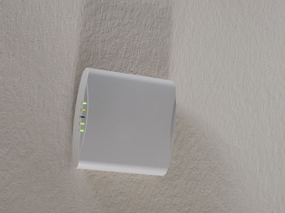

master ap
att gateway
