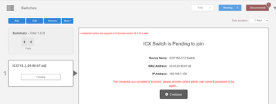

My home has ICX7150-C12-Switch and 2 r510 ap. The Ruckus system seems to reset randomly. The ATT fiber router/modem is not as internet is available through ATT. The switch does not show up in the Unleashed app but the access points do. I connected my laptop directly to the switch but cannot get pass the login (192.168.1.100) using any of the passwords I originally got from the tech ( super &sp-admin, admin & ruckus). Called Ruckus and they say i must post to forum. Any assistance would be appreciated. Home built in 2019.
08-01-2023 07:16 AM
The log exceed 20000 characters so i am attaching first part. Note I have one of the access points unplugged, but plugged it back in about 15 minutes before generating the log.

Hi @ajc
Based on the description it seems like SSH and LLDP were not enabled, so please try to upgrade it using the below commands.
Switch(config)#configure terminal
Switch(config)#crypto key generate
Switch(config)#aaa authentication login default local
Switch(config)#lldp run
Switch(config)#write memory
Note: give 10 minutes after changes, if it does not join, hit add from the Unleashed dashboard.

Unable to login with all the suggested passwords. I tried to reset passwords using the suggested links but cannot get the terminal to accept input in boot. Tried both Mobaxterm and Putty. attaching screen shot below.

07-26-2023 03:53 PM
Hi
Tried the various password combinations and none work when I log in from the ruckus web page at 192.168.1.100. I tried to login via wifi and via ethernet. I am able to login from the app but cannot see the switch in the app. The app login credentials does not work on the webpage.
One r510 has all LED green except AIR is unlit.
Second r510 has all LED Lit except CTL and AIR are unlit.
07-27-2023 05:44 AM
Hi @ajc
If the credentials doesn't work we need to perform the password recovery process.
We need physical access to the ICX-7150-Using the console connection
Here is a short guide :
Short Guide for password recovery :
Video link as reference : https://www.youtube.com/watch?v=XJS28DWbHM4
1.Start a CLI session over the serial ( console access) interface to the RUCKUS ICX device.
2-Enter OS mode. This uses a key combination and drops below the fastiron operating system
Key Combination: Ctrl+y, release, tap 'm', tap 'Enter'
OS>
4-just write reset
OS>reset
5-.While the system is booting, before the initial system prompt appears,
enter b to enter the boot monitor mode.
Enter 'b' to stop at boot monitor: 0
In this Part you have to press B before the counter ends
6-Enter no password. (You cannot abbreviate this command.)
ICX7650-Boot> no password
00 00 00 00
OK! Skip password check when the system is up.
7-Enter boot. This command causes the device to bypass the system password
check.
ICX7650-Boot> boot
8-After the console prompt reappears, assign a new password.
device> enabledevice# configure terminal
device(config)# username USERNAME password PASSWORD
