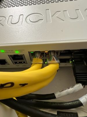

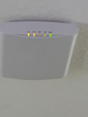

Thanks for your directions, I did the access point reset and everything is fine , but the lights look like that:
And switch has an orange light where the access point in question is connected :

Hi @Btissam
Thanks for your response.
Based on the description, the light on the Radios 2.4 and 5g shows Amber when the WAP is configured but no clients are connected to that specific radio or WAP.
Please try the following troubleshooting steps.
1. Hard reset the AP using a paper clip to factor default it. Press and hold the FD pinhole for 40 secs.
2. Create a Test SSID
3. Try to connect any client to the SSID.
Note: In case the client doesn't connect to 5GHz, then for testing, disable 2.4 GHz radio on the AP and try to connect to the AP on 5GHz to verify if the client is getting associated and the LED turns Green.
Please try the above mentioned steps to see whether the lights turn green or not.
