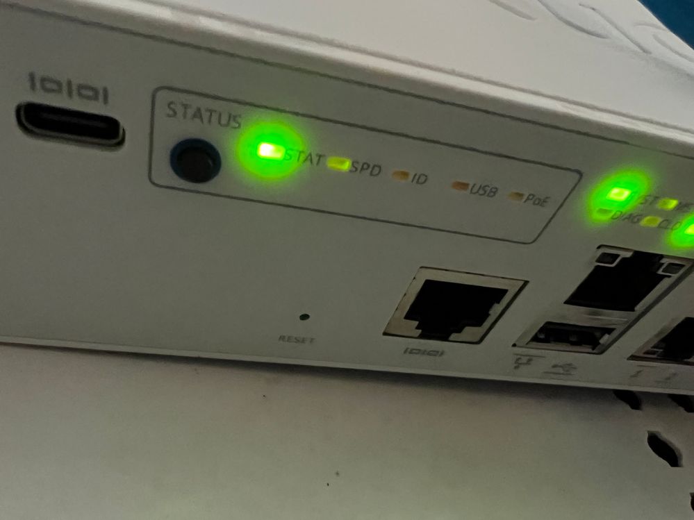

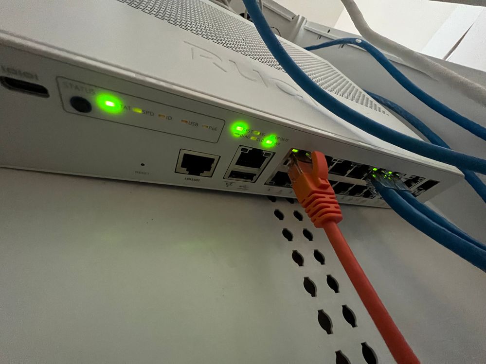

2. On your switch while it's plugged into the outlet, do you see any lights on? (Amber or green) Please let us know which lights are on. (Please refer to the below picture and share a picture of the same, showing the light status and the cable connections to the Switch ports)

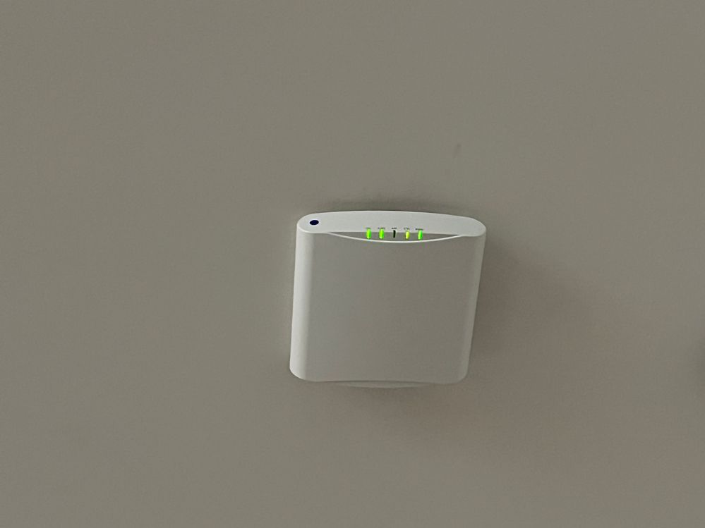

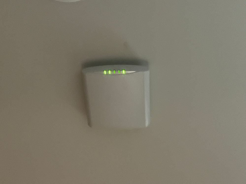

3. May I know how many Access Points are connected to the Switch? Could you please let me know the light status on the Access Points? Any of these lights are on (Please refer to the below picture and share a picture of the same)
All the lights of the switch are green. I have 2 access points. I am uploading pictures of Switch and 2 access points.
IMG-1147.jpgIMG-1148.jpgIMG-1149.jpgLower Level Access PointLower Level Access PointUpper Level Access PointUpper Level Access Point

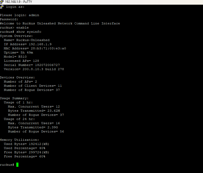

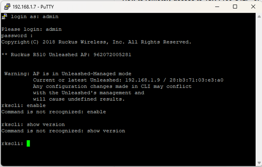

This issue may happen when the Switch runs on the Routing code (SPR). The Switch should run on the Switching code (SPS) to avoid these issues for Lennar home users. If the Switch boots up on the other partition (Due to a power outage/power spike) which may be running on a ‘Routing Code’ results in causing this issue. To check the same please follow the below process.
ICX7150-C12 Router> OR
ICX7150-C12 Switch>
show version
show flash
I am sharing Putty Output using the three IP addresses that I got from IP scanner app.
Screenshot 2023-06-19 163347.pngScreenshot 2023-06-19 163638.pngScreenshot 2023-06-19 164130.png
