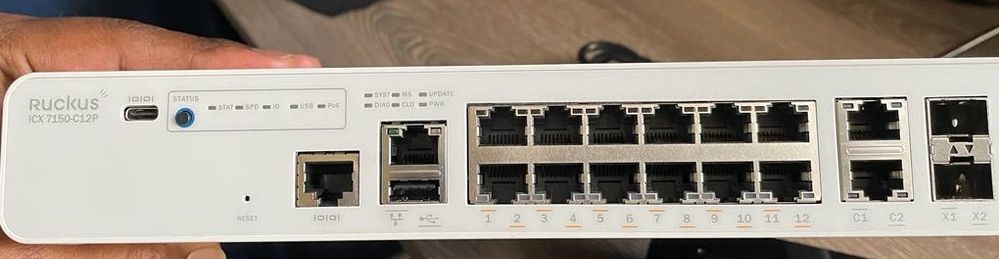

Hello Team, Hope you are doing well. I have Ruckus switch ICX 7150-c12p in the home and all in sudden it stopped working. I tried to debug on my own using the steps provided in the other cases but even reset is not working. I can see Orange lights coming up for a second when I power on then nothing. Looking for your help. Now, all the IoTs connected to the AP is down.
I tried the below steps
1-Please try to disconnect from the Power outlet the ICX-7150 and reconnected.

Thank you for sharing the requested PICTURES and a VIDEO.
Based on the troubleshooting done, your ICX-7150-C12P Switch is not powering up, and when plugged in, it flashes an amber light and then goes dark. And you confirm that the Switch is plugged into a well-known outlet/power source. However, the failure persists. This Switch unit Should be RMA (Return Merchandise Authorization) in simple words replacing it.

Hi @nnayagam
As per the case description, I understand that your RUCKUS ICX-7150-C12P Switch is not powering up.
Could you please plug your ICX-7150-C12P Switch into a working power outlet and send us PICTURES and VIDEO of it showing the light status, and cord connected to the Switch and a working power outlet? Please refer to the below pictures as an example.

Thank you for the quick reply. Please the see the short video (link to Google drive is below). As I mentioned, the lights blinks for a second then nothing. Looking for your support in resolving this
