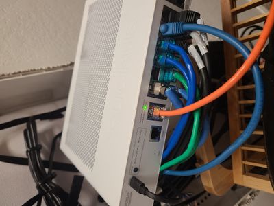

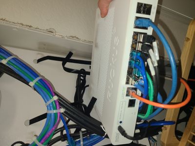

Hi @Spencer
As per the case description, I understand that your RUCKUS setup is not working, after a power outage.
1. On your switch while it's plugged into the outlet, do you see any lights on? (Amber or green) Please let us know which lights are on. (Please refer to the below picture and share a picture of the same, showing the light status and the FULL Switch panel cable connections to the Switch ports)

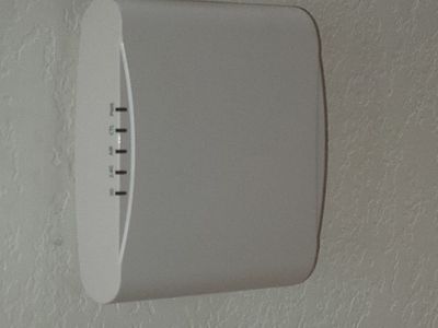

2. May I know how many Access Points are connected to the Switch? Could you please let me know the light status on the Access Points? Any of these lights are on (Please refer to the below picture and share a picture of the same)
Please let me know the answers to ALL the above queries or let me know if you have any queries in this regard.
None of the lights on the access point are on and just the power and system lights are on on the switch
โ€ƒ
โ€ƒ
Hi @Spencer
As per the light status of the RUCKUS ICX-7150-C12P Switch it seems to be normal and doesnโ€™t require a software recovery. Please unplug and plug the Access Points ethernet cables from the Switch ports and check if they get power back.
If that doesnโ€™t work, we need to check the Switch port configuration and fix it. Please follow the process explained in the Lennar Knowledge Base guide below may help you get this issue resolved.
https://community.ruckuswireless.com/t5/RUCKUS-Lennar-Support-Knowledge/NO-Power-on-Access-Points-an...
Before you proceed with the above process, I see from the picture you shared, seems like the ethernet cable which is coming from the ISPโ€™s (Internet Service Providerโ€™s) Router or Modem/Router combo is plugged into the wrong port on the Switch panel. It must be plugged into any 1 in-12 ports as shown in the below screenshot. Please unplug the ethernet cable and plug it into the correct port. If required reboot (unplug and plug from the power outlet) your Switch once after plugging it into the correct port.
Plugged the ISP where you said, still no change. Also, you cant tell in the picture but the system LED is FLASHING green, shouldnt that be solid?
