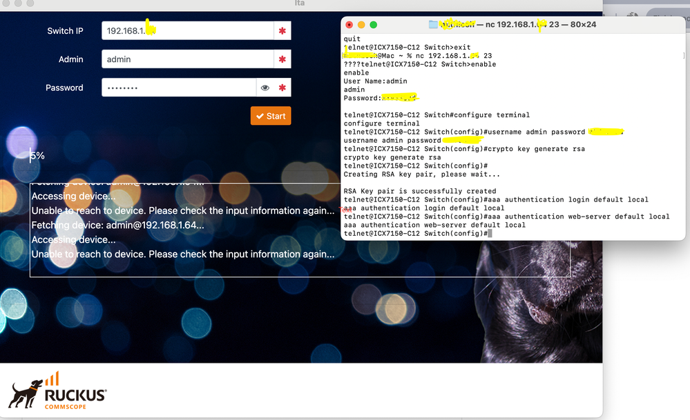

As you asked me to create a new ticket, so here it is. There was a power outrage in my home. After that, the wifi got really slow. Before that, the switch ICX 7150 used to show 'disconnected' in the unleashed dashboard. Also, it didn't have the latest firmware to work with unleased. However, I had ignored it because the wifi was working fine, and I got busy at work.
After the recent power outrage, I went through some topics here and found similar issue raised by members. I tried to fi it myself so I did hard reset on switch because I didn't have login/password credentials and none of the default credentials worked. After the hard reset, the switch has no IP address. I would need your help to configure the switch to its latest firmware, and to be able to connect it in the unleased. I hope after this fix, the wifi should start functioning properly. I have Macbook and no windows laptop to work with.

Since you are encountering the message "Key already exists. Please zeroize it", (below is the screenshot) please run the following command and then repeat the reset steps:
Commands:
configure terminal
crypto key zeroize rsa
After completing the reset username/password once again, try using the upgrade tool again.
If the issue persists, could you please attempt running the upgrade tool on a Windows laptop?
Thank you once again for your patience.
