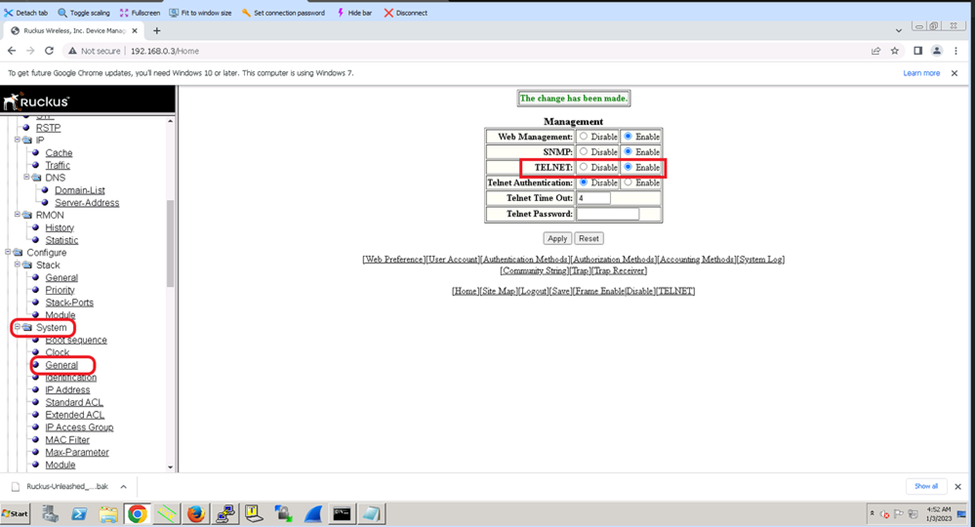

To proceed, please log in to the Switch through a web browser. You should see the Switch Dashboard (as shown in the screenshot below), which will confirm that you are accessing the correct Switch IP address.
Once logged in, please enable Telnet (refer to the screenshot provided).

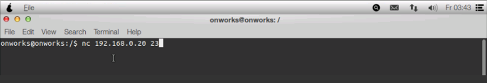

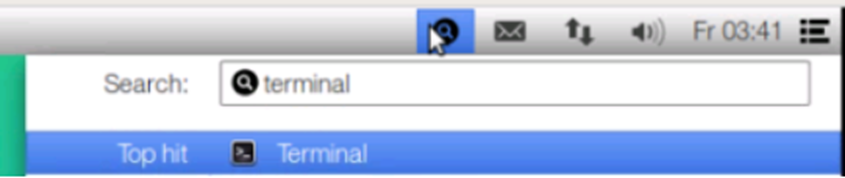

After enabling Telnet, try accessing the CLI from your Mac terminal by following the steps below, and share the output of the commands listed in this post:
Open the terminal on your Mac.
Run the following command (replace <ip address of the switch> with the actual Switch IP):
nc <ip address of the switch> 23
Example:
nc 10.0.0.132 23
Please let me know how it goes.
09-24-2025 07:20 PM - edited 09-24-2025 07:20 PM
I followed the steps. Just a correction that TELNET option is under system->management->general, and not under system->general.
Here is the output.
> nc 192.168.1.xx 23
????telnet@ICX7150-C12 Switch>
