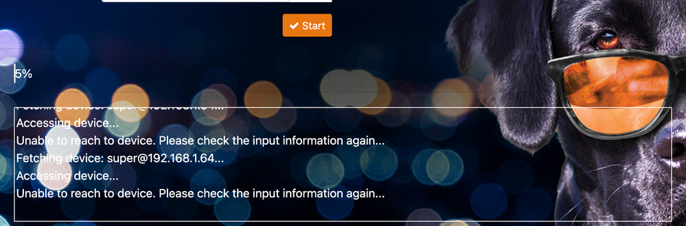

To facilitate this transition, we have recently introduced an upgrade tool tailored to ensure a seamless process. Utilizing this tool is straightforward: users simply need to input the IP Address, Username, and password associated with the Switch into the software interface.

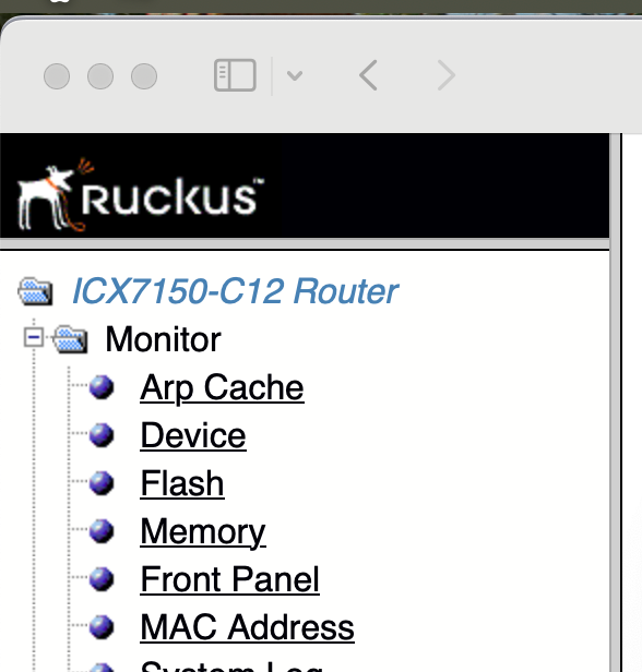

After following a similar thread, I had tried this step yesterday but didn't work. I tried just now and didn't work. I have also attached the ICX IP access gui screenshot - to show that my credentials work, but the same credentials do not work in the upgrade software for mac.
09-19-2025 06:36 AM
Hi @mshrivas
Kindly ensure that only the IP address is entered in the ‘Switch IP’ field on the upgrade tool dashboard, without including ‘http://’.

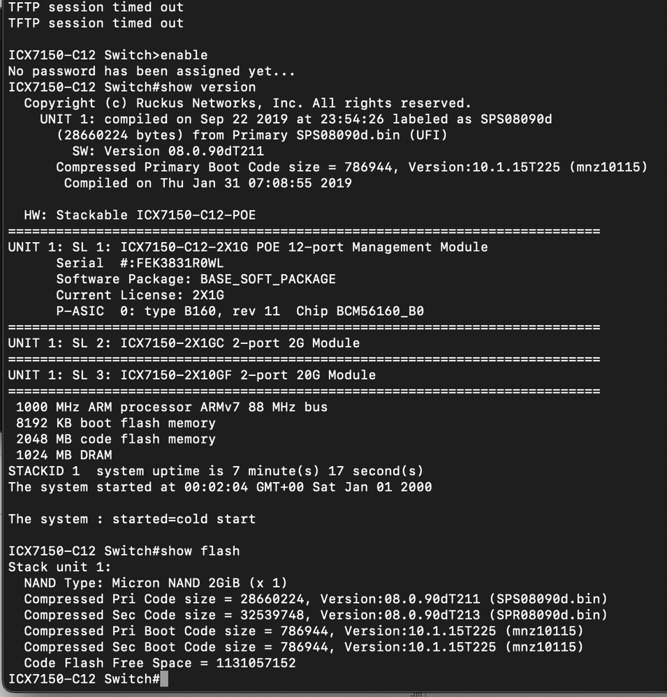

If the issue persists, please provide the outputs of the following commands from the Switch CLI:
show version
show flash
Please feel free to reach out if you have any questions or need further clarification.

I see the prompt as "ICX7150-C12 Switch>".
Let me provide you the outputs of your requests. Earlier, I was seeing ICX switch Router> , this time it shows ICX switch>
