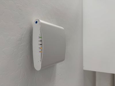

1. I do not see RUCKUS on WiFi network.
2. All lights are green on RUCKUS but downstairs way is amber
 3. Yes

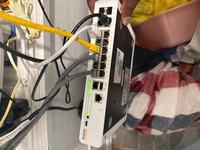

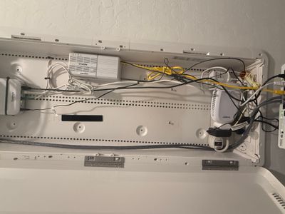

4. 2 access points I have sent picture above

Based on the light status indicators of the RUCKUS ICX-7150-C12P Switch and the R510 Access Points, everything appears to be functioning normally. However, from the picture you shared, it seems that the Ethernet cable from your ISP’s router or modem/router combo is connected to the incorrect port on the switch. It should be plugged into one of the 12 designated input ports, as shown in the screenshot below.
Please unplug the ISP Ethernet cable and connect it to the correct port. Additionally, reboot your ISP router by disconnecting it from the power outlet and then plugging it back in. After doing so, please attempt to check and connect to the Internet via the Access Points.
