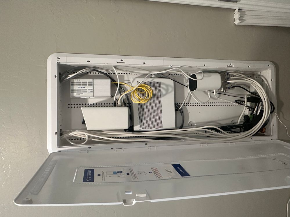

I recently switched carriers to Cox and neither of my ruckus extenders are working now. Only getting a red light. Need help resetting so they work, please

I will see if I can get a picture of that, as you can see it is not facing in a way for me to get a picture.

Hi @Gbunch702
As I see from the picture you shared, seems like the ethernet cable which is coming from the Router is plugged into the wrong port on the Switch panel. It must be plugged into the 1 in-12 ports as shown in the below screenshot.

Okay, I switched the port. What are the next steps?

Hi @Gbunch702
Now you can check your APs and try to access the Internet. If APs still have Red color light, please unplug and plug both the AP ethernet cable (Cables marked in the screenshot below) on the Switch and try to connect.
