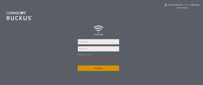

Hello @sanafsyed09 ,
Thank you for sharing the screenshot.
From the screenshot you shared, it seems that you are able to able to access the Unleashed login page.
Once you see the above dashboard, please try to use the default combination credentials as mentioned below.

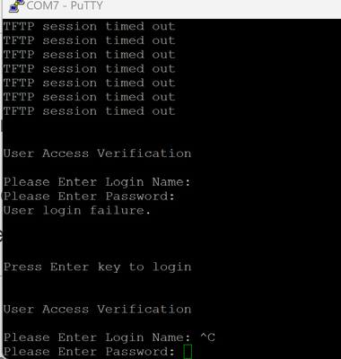

sanafsyed09
Hi Pinky
1. I followed the steps in "Fixing “host 192.168.0.x is not alive” (not alive) error during the Switch Software Recovery Process"
and I am getting the following in Putty
TFTP session timed out
User Access Verification
Please Enter Login Name:
Please Enter Password:
User login failure.
Press Enter key to login
2.I don't have ethernet socket in my laptop. So I connected the ethernet cable to an ethernet to USB-C. I then connected USB-C to my laptop.
User login failure.
Please Enter Login Name: ^C
User login failure.
ecit
Please Enter Login Name: exit
User login failure.

Good news. I see green lights now. Please let me know how do I login to unleashed.ruckuswireless.com/admin/login.jsp
pinky_ruckus
Valued Contributor III
