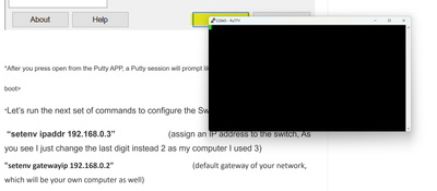

Hi Pinky, I have tried resetting and it didn't work. I doing software recovery and I don't see boot option
12-01-2024 10:26 AM
Hi Pinky, I tried again with the paper clip and the yellow lights have been blinking continuosly since 30 mins. I again tried software recovery process and I don't see boot option in putty. Please help

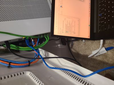

I would request you to please share the cable connection between the Switch and the laptop while performing software recovery. (Please see the below picture as reference)

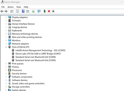

Also, please share the screenshot of the COM port details. COM port details should be with the silicon lab name in the device manager.
I would request you to please check if both the drivers are installed as per the software recovery article.

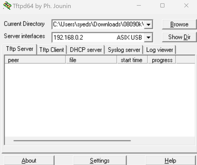

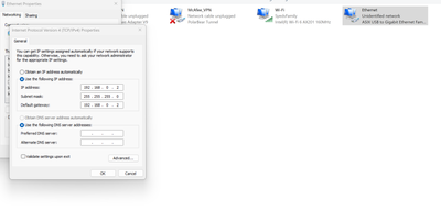

I have connected cable connection between the Switch and the laptop and also the Ethernet cable connected between the Out-of-band management port in the Switch to your computer Ethernet port.

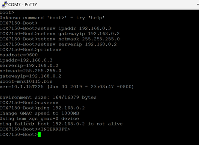

I see the below in Putty. The response in not alive. I am unable to attached screenshots here
boot>
Unknown command 'boot>' - try 'help'
ICX7150-Boot>
ICX7150-Boot>setenv ipaddr 192.168.0.3
ICX7150-Boot>setenv gatewayip 192.168.0.2
ICX7150-Boot>setenv netmask 255.255.255.0
ICX7150-Boot>setenv serverip 192.168.0.2
ICX7150-Boot>printenv
baudrate=9600
ipaddr=192.168.0.3
serverip=192.168.0.2
netmask=255.255.255.0
gatewayip=192.168.0.2
uboot=mnz10115.bin
ver=10.1.15T225 (Jan 30 2019 - 23:08:47 -0800)
Environment size: 164/16379 bytes
ICX7150-Boot>saveenv
ICX7150-Boot>ping 192.168.0.2
Change GMAC speed to 1000MB
Using bcm_xgs_gmac-0 device
ping failed; host 192.168.0.2 is not alive
ICX7150-Boot>
