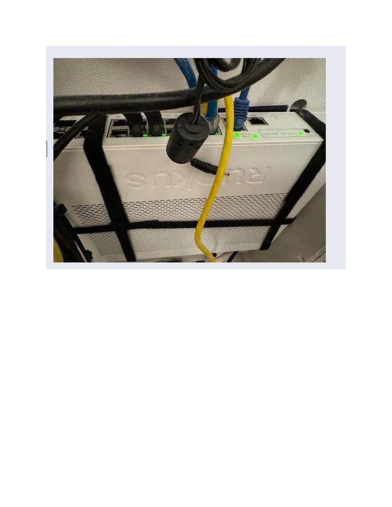

2. On your switch while it's plugged into the outlet, do you see any lights on? (Amber or green) Please let us know which lights are on. (Please refer to the below picture and share a picture of the same, showing the light status and the FULL Switch panel cable connections to the Switch ports)

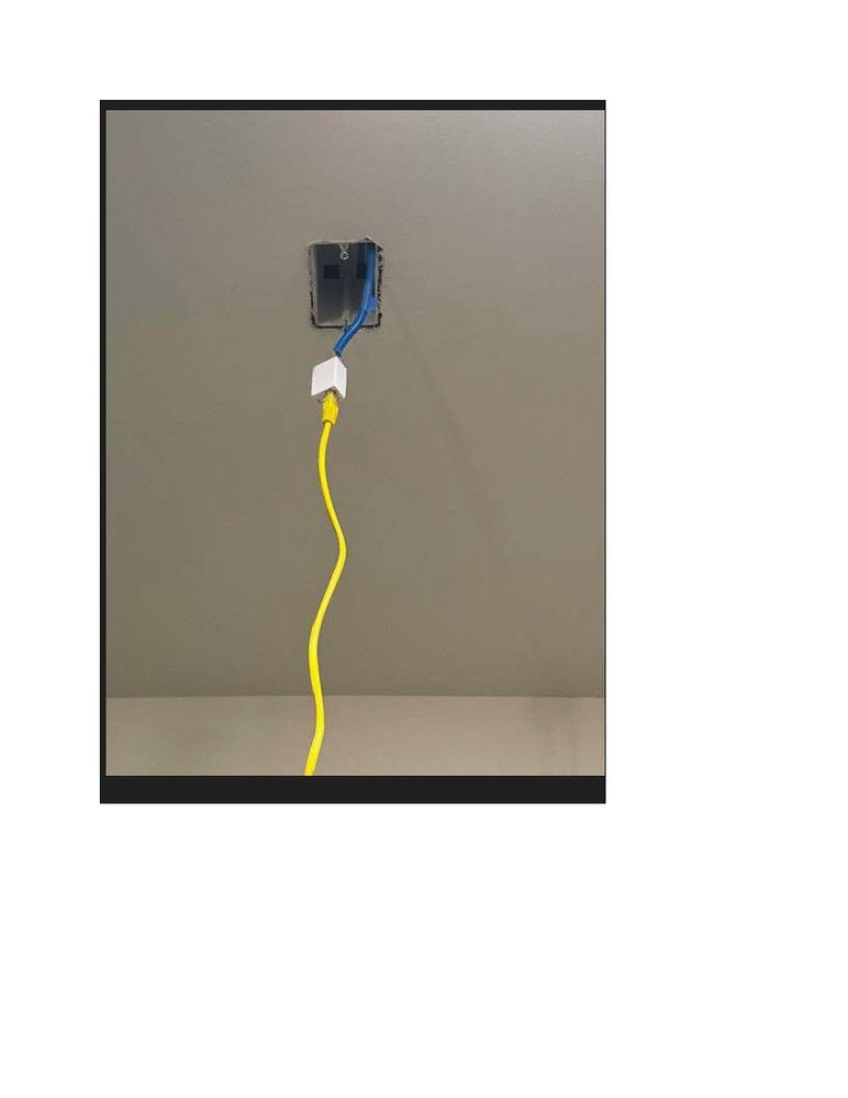

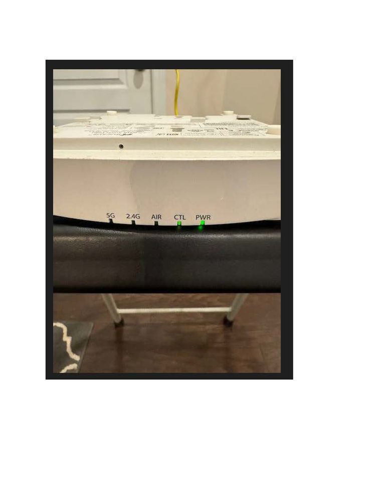

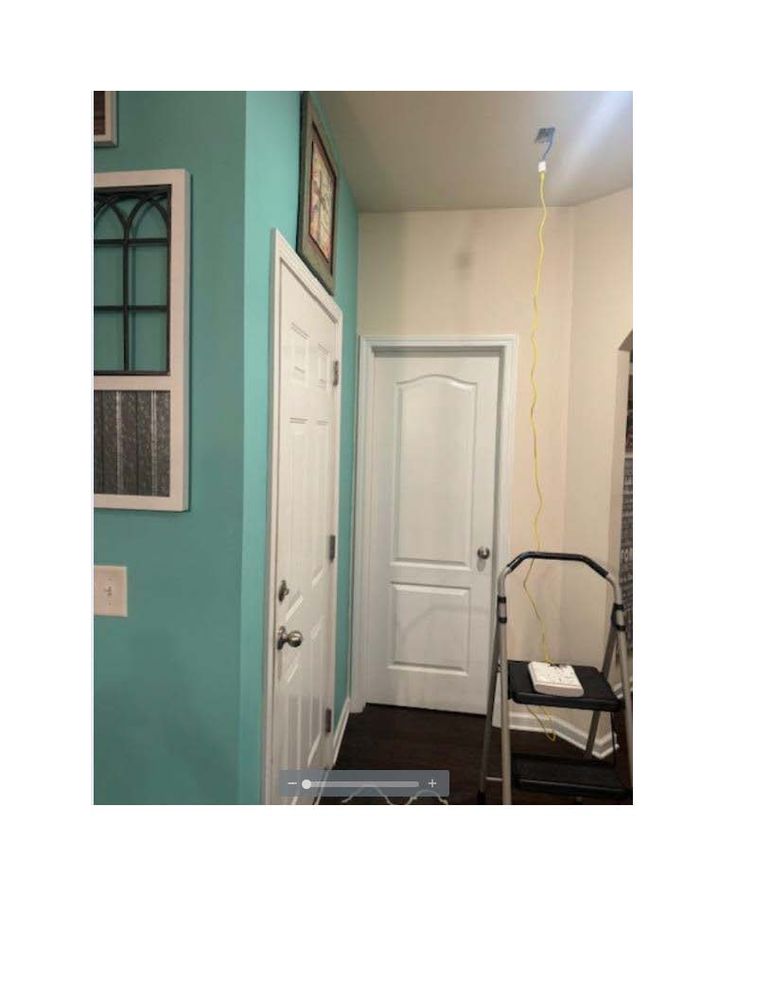

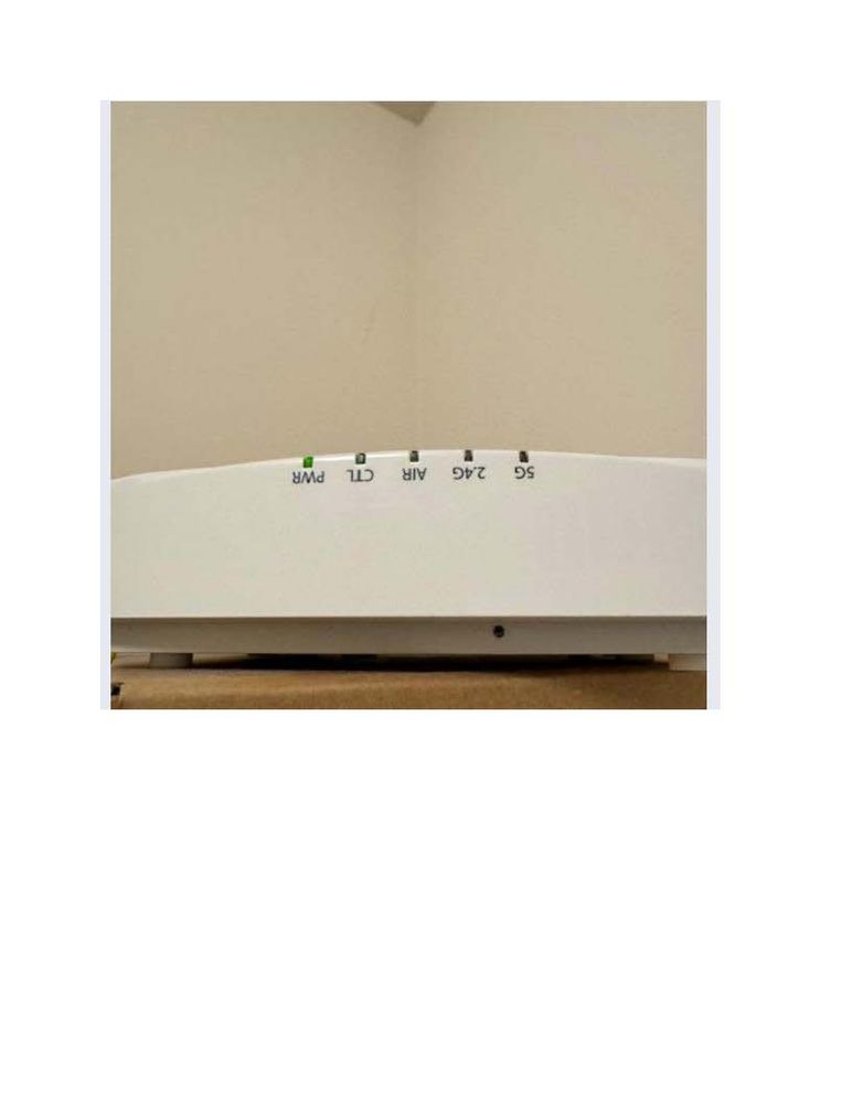

1) It was working before, no power outage.2)Power is on green and the CLT blinks green. No other lights are on. 3)Yes 4)2 access points we have. One access point has no lights on.
We have two Ruckus Access Points R510

As per the light status of the RUCKUS ICX-7150-C12P Switch and the R510 Access Points, they seem to be in a normal status.
As I see from the picture you shared, seems like the ethernet cable which is coming from the ISP’s (Internet Service Provider’s) Router or Modem/Router combo is plugged into the wrong port on the Switch panel. It must be plugged into any 1 in-12 ports as shown in the below screenshot. Please unplug the ethernet cable and plug it into the correct port. Reboot (Unplug and plug from the power outlet) your ISP Router and RUCKUS ICX-7150-C12P Switch once then try to connect to the Internet via Access Points.
