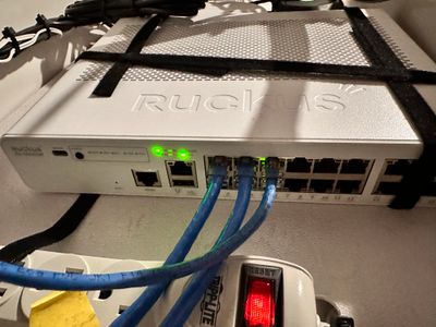

On your switch while it's plugged into the outlet, do you see any lights on? (Amber or green) Please let us know which lights are on. (Please refer to the below picture and share a picture of the same, showing the light status and the FULL Switch panel cable connections to the Switch ports)

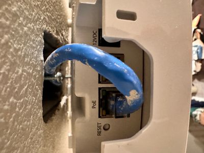

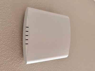

The first 2 cables are connected to the APs and the third is from the modem. Below is the picture of a AP with no power, it is connected to the switch on PoE port.  
Hi @shantnu
As per the picture you shared, Switch seems to be in a normal state. However, we may have to check the Switch PoE ports configurations/information to know and troubleshoot to get the PoE ports working.
