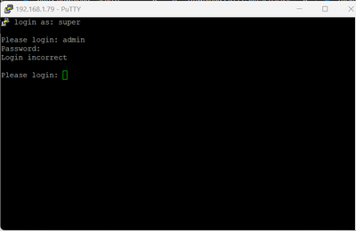

None of those usernames or passwords work. Whats the next option? Can you perform a system check if i give you access to my system?
Hi @Antoniobaker09
Thanks for your reply.
If default credentials do not work, please follow the below steps to reset the Password on the ICX-7150-C12P Switch
Please follow the below guide to perform password recovery.
Password Recovery on a Ruckus ICX Tutorial video
https://www.youtube.com/watch?v=XJS28DWbHM4
Recovery Process
1. Console access to the switch.
2. Reboot the switch with the console cable attached and press "b" until the following is displayed.
3. Using the following commands to remove the password
  • no password
  • boot
4. Set new password commands.
Enable
config t
username super password pass
Where super is the username and pass is the password
Wr mem
exit
Reload
Are you sure? (enter 'y' or 'n'): y
