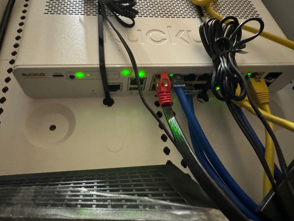

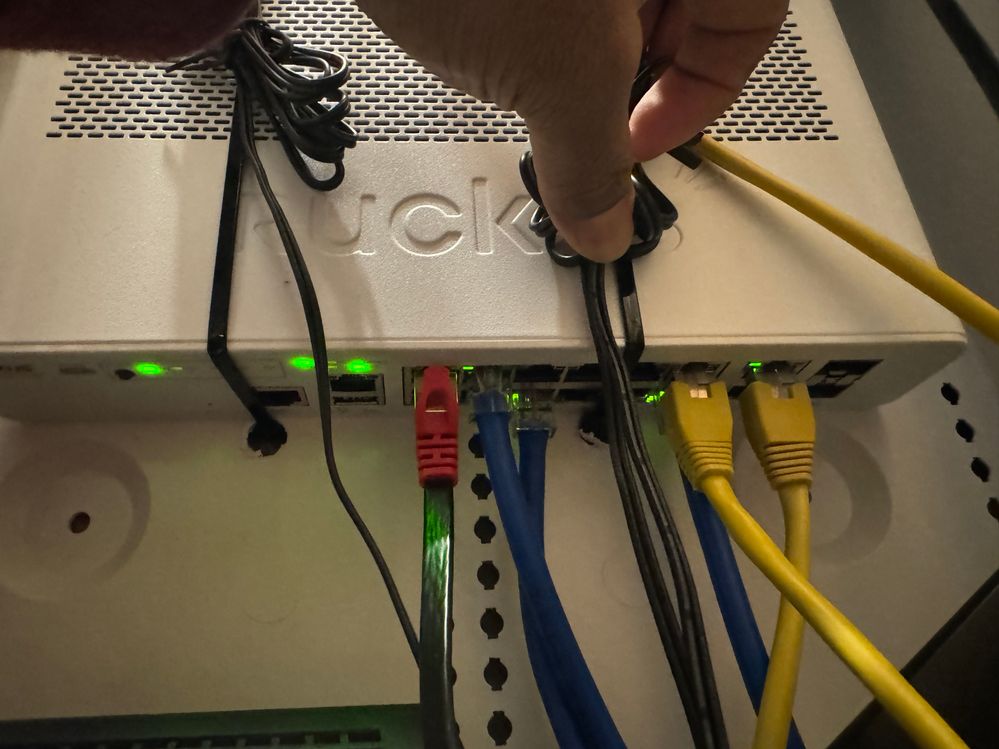

2) On your switch while it's plugged into the outlet, do you see any lights on? (Amber or green) Please let us know which lights are on. (Please refer to the below picture and share a picture of the same, showing the light status and the FULL Switch panel cable connections to the Switch ports)
3) May I know how many Access Points are connected to the Switch? Could you please let me know the light status on the Access Points? Any of these lights are on (Please refer to the below picture and share a picture of the same)
12-10-2024 08:58 AM
picture without flash light - All ports have green light
picture with flash light - All ports have green light but not visible. This is just to show list of ports connected to switch
Ruckus AP located at Basement- Yellow light for 2.4G. Green light for 5G and Power
Ruckus AP located at Main Level- Green light on all except AIR
Ruckus AP located at Upstairs - Yellow light for 5 G, Green light for 2.4 G and Power
One more picture of Ruckus Switch with all green lights

From the pictures you shared, it seems like the ethernet cable which is coming from the ISP’s (Internet Service Provider’s) Router or Modem/Router combo is plugged into the wrong port on the Switch panel. It must be plugged into any 1 in-12 ports as shown in the below screenshot. Please unplug the ethernet cable and plug it into the correct port then reboot (unplug and plug from the power outlet) and try to connect to the Internet via Access Points.
It should be plugged into one of the 12 ports as shown in the below screenshot.
