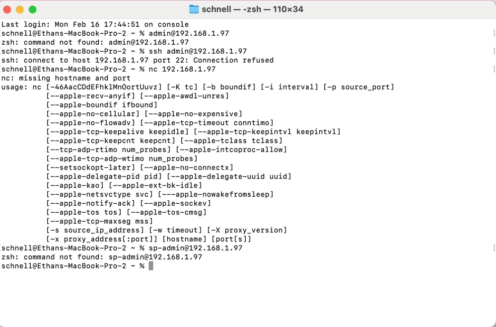

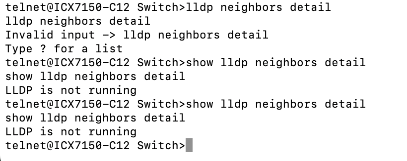

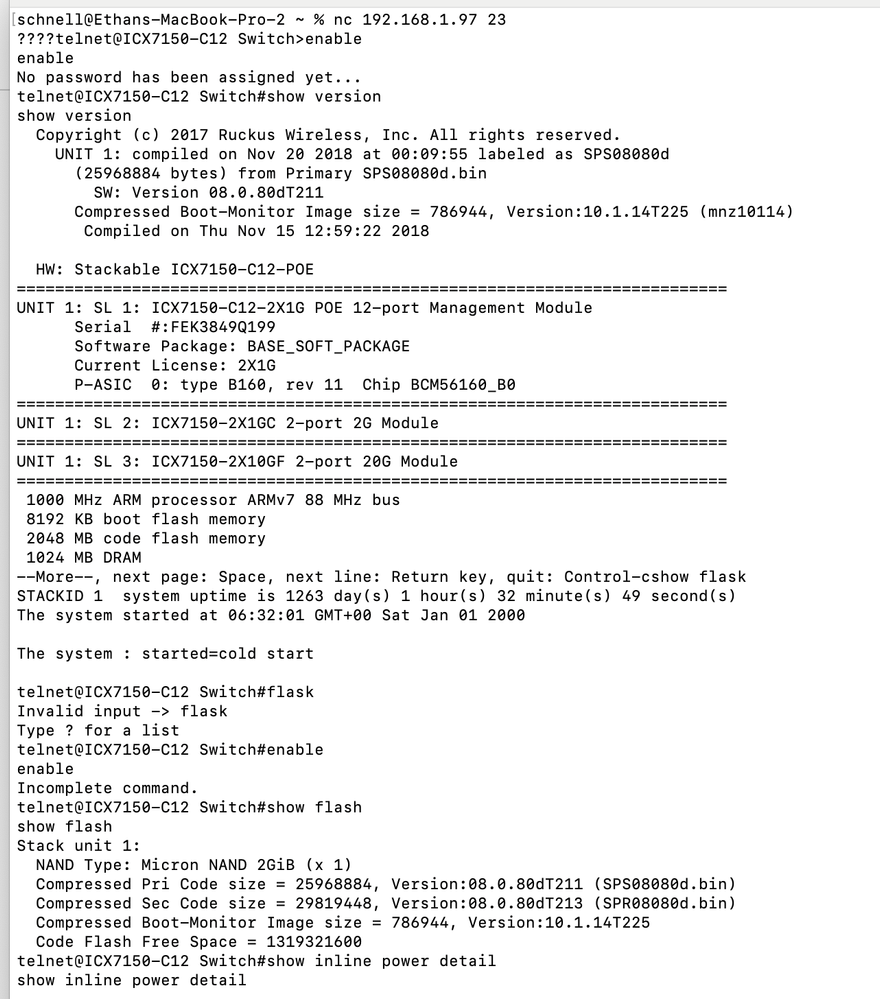

found terminal, but got this...see image, now what??Screenshot 2026-03-30 at 3.15.25 PM.png
Screenshot 2026-03-30 at 3.28.56 PM.pngScreenshot 2026-03-30 at 3.29.10 PM.pngScreenshot 2026-03-30 at 3.29.19 PM.png

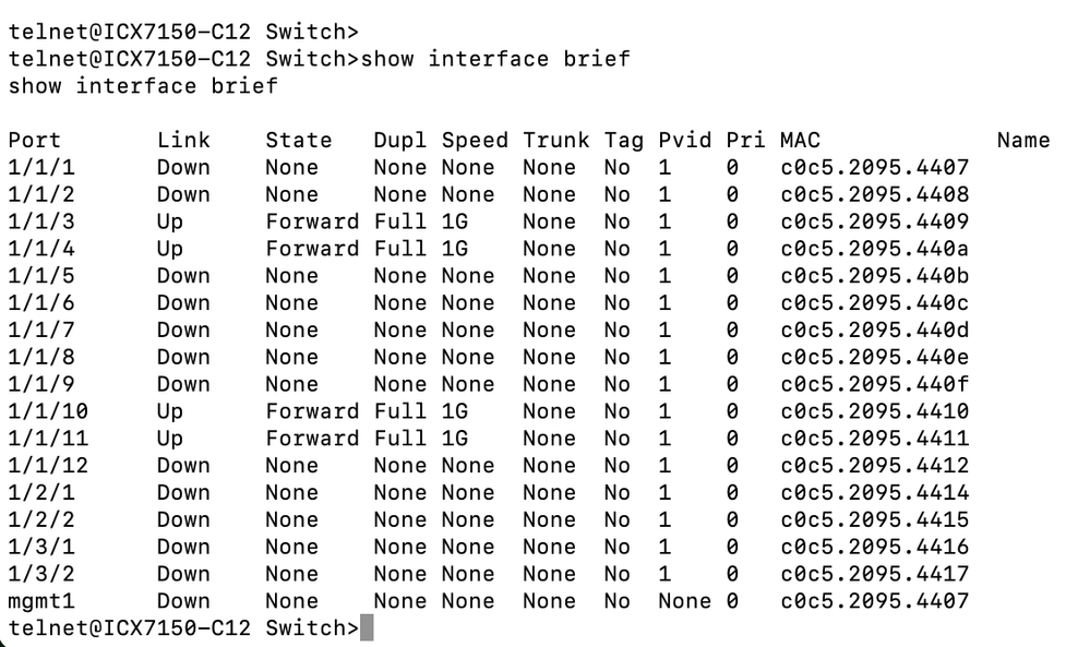

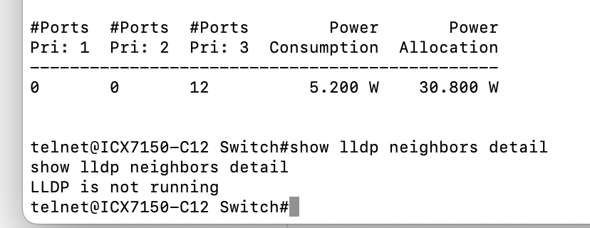

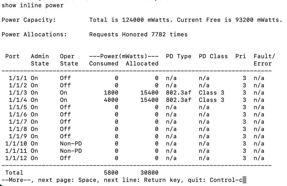

Could you please share the screenshot for the output of the commands show inline power and show interface brief to proceed further?
Could you please try disconnecting the AP cable from the Switch and try reconnecting and check if it is working?
Also, from the screenshots shared, I could see that you are getting an error while performing the command lldp neighbors detail?
I would request you to perform another command lldp run and then perform lldp neighbors detail to get the output of the command.'

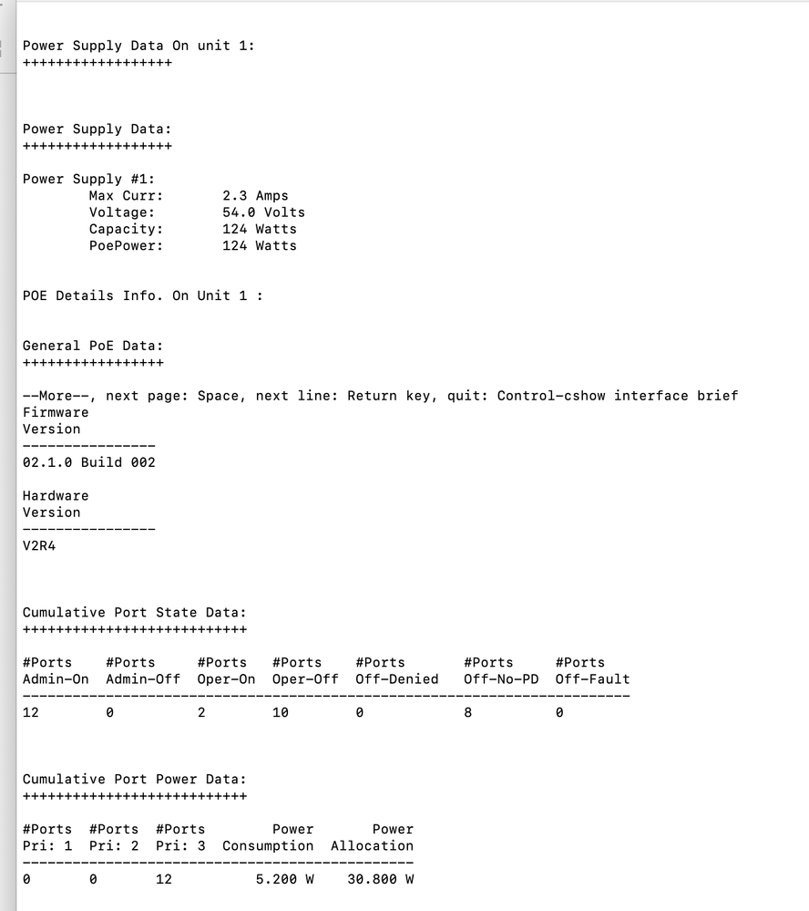

Could you please share all the screenshots for us to proceed further?
Screenshot 2026-03-31 at 2.00.09 PM.pngScreenshot 2026-03-31 at 2.00.59 PM.pngScreenshot 2026-03-31 at 2.04.18 PM.png
Here are the 2 screenshots requested... the lldp command does not work, please advise
I don't know which cable to unplug and plug back in...please advise

Based on the information provided, it appears that one of your RUCKUS Access Points is not working.
Please share the serial number of the non-working Access point.
