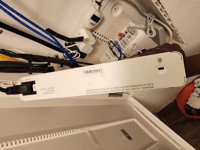

here is the front panel

As per the case description, I could understand that your RUCKUS setup is not working, and Access Points do not have power after a power outage.
As I can see from a picture you shared, there are lights on PWR and SYST, if there is an amber/orange light on the "SYST" and a green light on the "PWR" on the Switch (as it is in the below picture). Meaning the Switch is stuck in the boot mode.
Basically, due to the power outage/ power spike, the switch went to a state that we call ‘boot mode’ that is not able to boot up properly.
As you mentioned that you tried reset, once again we will try to reset the Switch as described below:
  • Remove power from the switch.
  • Press and hold the Reset button while applying power to the switch.
  • After all the system LEDs flash amber, release the Reset button.
IF RESET IS NOT WORKING, PLEASE TRY TO RESET YOUR SWITCH MULTIPLE TIMES (Like 10-15 times) AS DESCRIBED ABOVE.
