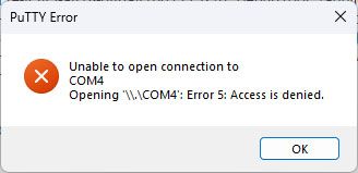

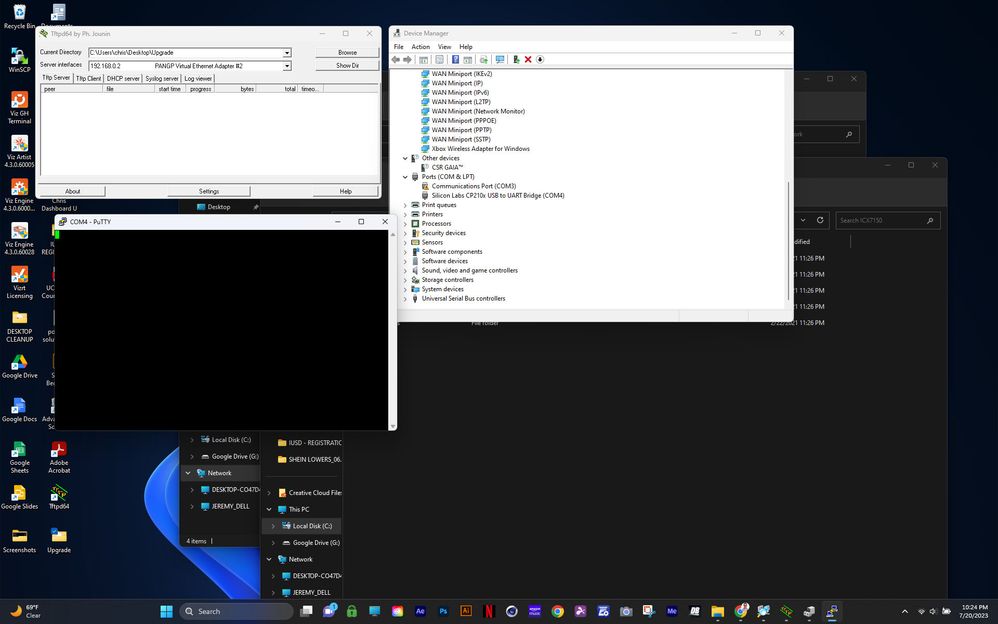

Hello! Still no access to the switch via unleashed/the old IP address, so attempting the software recovery process. However, I did run into a problem with Putty. No command line appears and I cannot type anything within the shell. Any suggestions?PUTTY Not Working.jpg
And also got this when right clicking on Putty to try to create a duplicate session
Hi @chrisjor71
May I please know the reason you are trying to access CLI using the COM port?
As mentioned previously, please plug the ethernet cable coming from the ISP Router into the correct plug and restart the devices. Check the Internet connectivity.

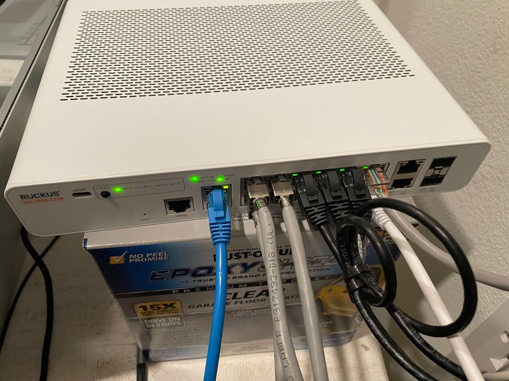

Thank you for the quick reply! I do have the ISP router cable placed in one of the 1-12 ports as previously instructed (picture attached). I was trying other cabling solution to establish a connection since COM3 was giving me an alert warning in the device manager. I have removed that, and now I just have the ethernet (blue cable) to my PC laptop (running windows 10)

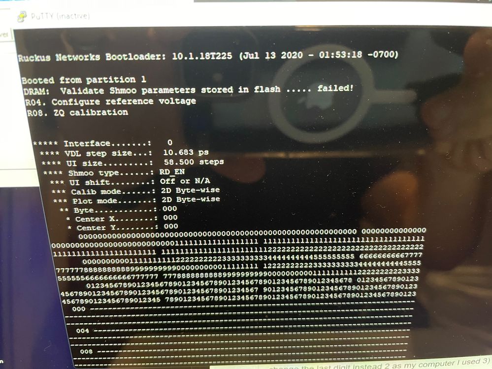

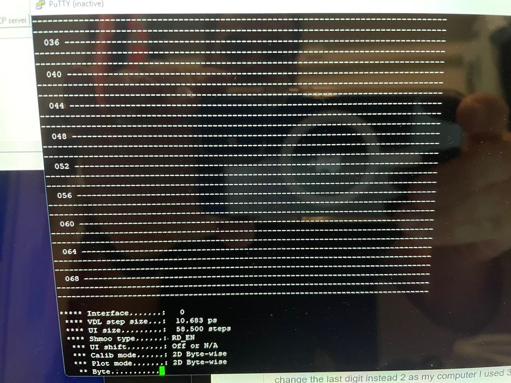

Steps this morning have included a reboot of my AT&T router, as well and a restart of the Ruckus switch. Green lights returned in a timely fashion - so no repeat of the boot mode issue - a relief! However, I'm still unable to enter any commands in putty - and this is what that interface returned from the Ruckus Switch (pictures attached as well)
