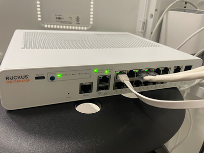

Can someone please help me. I having issue with my Lennar Ruckus Switch (ICX-7150-C12P).
1. Un-stable/slow connection.
2. Unable to connect switch from Unleashed web/App.
3. Unable to connect the switch from console port also.
Please find the below error message in dashboard.
:Failed to ping ICX 192.168.x.xx. Suggest checking the network.:
*Unleashed system only supports ICX firmware version 08.0.90 or later.
Switch’s Console ports are not responding. I have tried different troubleshooting steps however, the failure persists, and unable to perform the software recovery on the Switch.
Can you please someone help me to fix the issue.

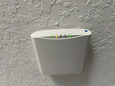

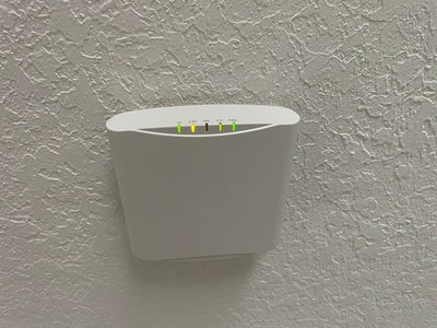

AP2:
If you connect to console and reboot the switch and follow the below steps, are you able to go to boot mode -

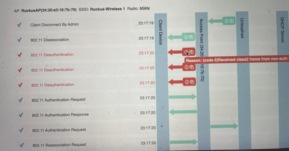

Switch console ports are not responding. I have tried all troubleshooting steps, but still problem persists. switch is not connecting - attaching the screenshot from unleashing portal as well.

04-22-2024 01:09 AM
Hi Tandemsankar
Thanks for reaching us.
From the front panel of the switch looks like there is no amber LED noticed. So switch is booting up with the code.
Could you please let me know if you are aware of switch IP address which was assigned to the switch if it is manual ?
If assigned from your router through DHCP check the IP assigned to switch from your router by logging into it.
If yes then try this
Thanks
