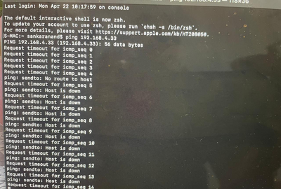

04-22-2024 07:40 AM
Hi Imran,
I have followed the above link, unable to get into Switch using console (CLI).
Switch’s Console ports are not responding also., personal opition somehow i feel its hardware issue. I would like experts to review.
I have connected with one of the free ports and tried ping Switch IP address. Please find the screennshot below.
