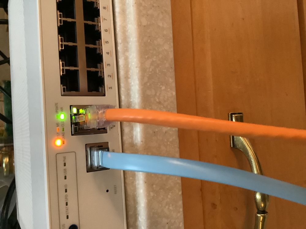

I am unable to get this switch to boot up.  I followed all of the instructions I was given to update and save the image and boot files and I completed a reset command the switch failed to boot.
The console displayed the following test after the reset command.
NAND read: device 0 offset 0x4000000, size 0x2000000
3 ecc_errors after reading  5efa000:5efbc00
Iproc_nand_read_page returned 2
NAND read from offset 4000000 failed -22
 0 bytes read: ERROR
## Loading kernel from FIT Image at 7000200 …
Bad FIT kernel image format !
ERROR : can’t get kernel image !
ICX7150-Boot>
The Switch displays a green PWR and an amber SYST light on the front panel.  None of the 12 network ports seem to be in working condition.  I tried to reply to your response to my original request for help but that reply was marked as SPAM and not accepted.

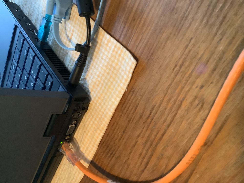

I hope these photos are clear for you
Hi @Rose_Jon
Thank you for your prompt response and the update.
As referenced in the screenshot below, the system is currently at the 'ICX7150-Boot>' prompt. Kindly proceed with the subsequent steps with installing required application or process, including executing the 'setenv' commands as outlined in the guide.
I appreciate your continued efforts on this matter and look forward to your update. Should you require any further information or assistance, please don't hesitate to reach out.
