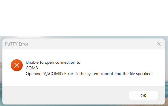

I had executed software recovery steps till the Putty COM3 screen. I am getting error when trying to connect to COM3

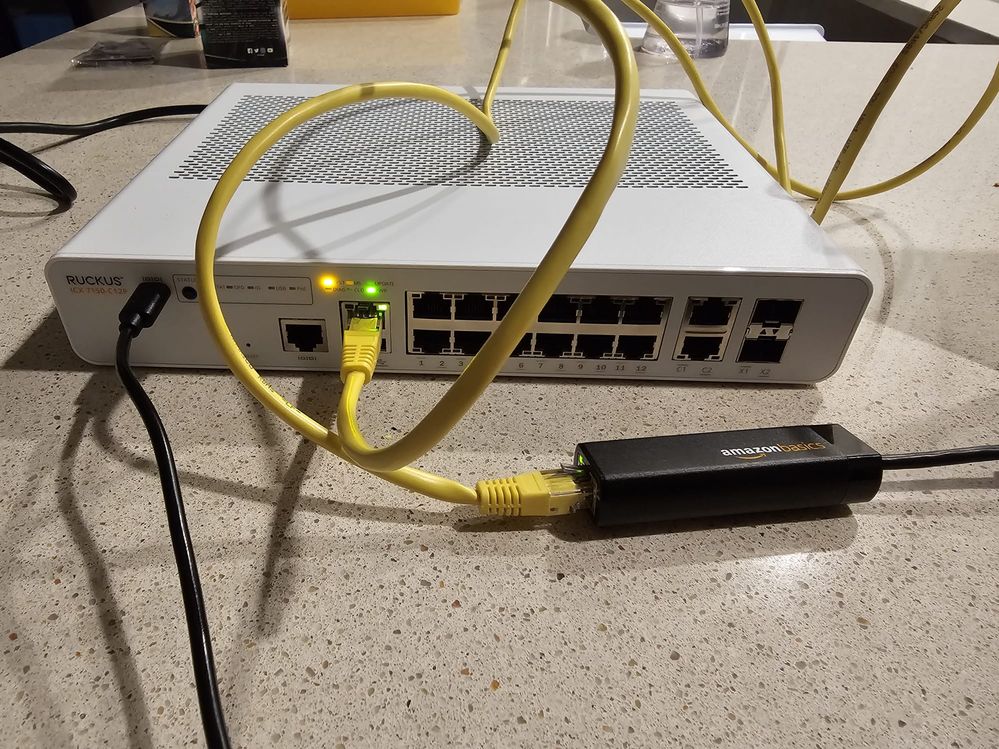

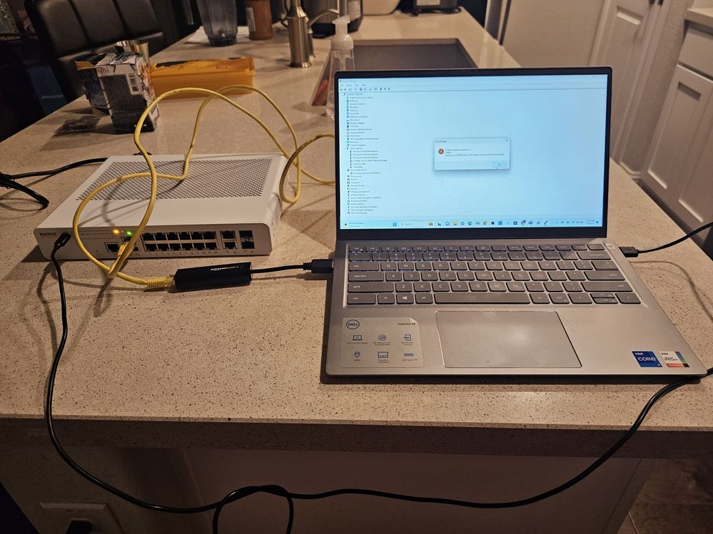

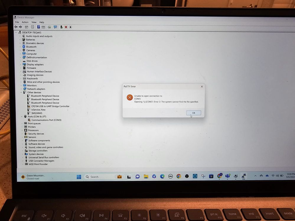

Hi @crazy007
Could you please share a picture showing the software recovery cable connections between the Switch and Laptop. Also, please share a screenshot of the Device Manager showing the COM ports information.
09-06-2023 06:23 PM
Here are the requested pictures
09-07-2023 09:02 AM
Hi @crazy007
Could you please double-click on the devices highlighted in the below screenshot and see what it shows? Also please help us with the screenshot of the same.
