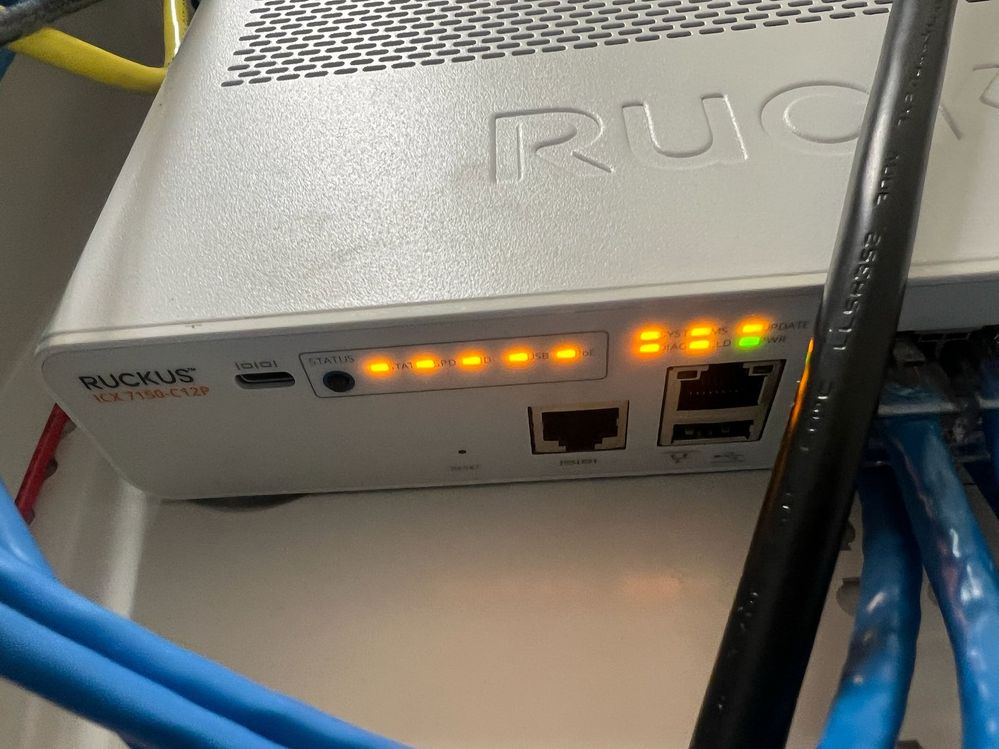

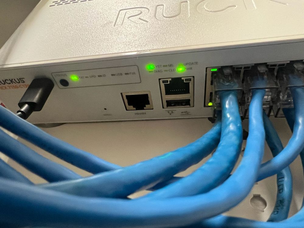

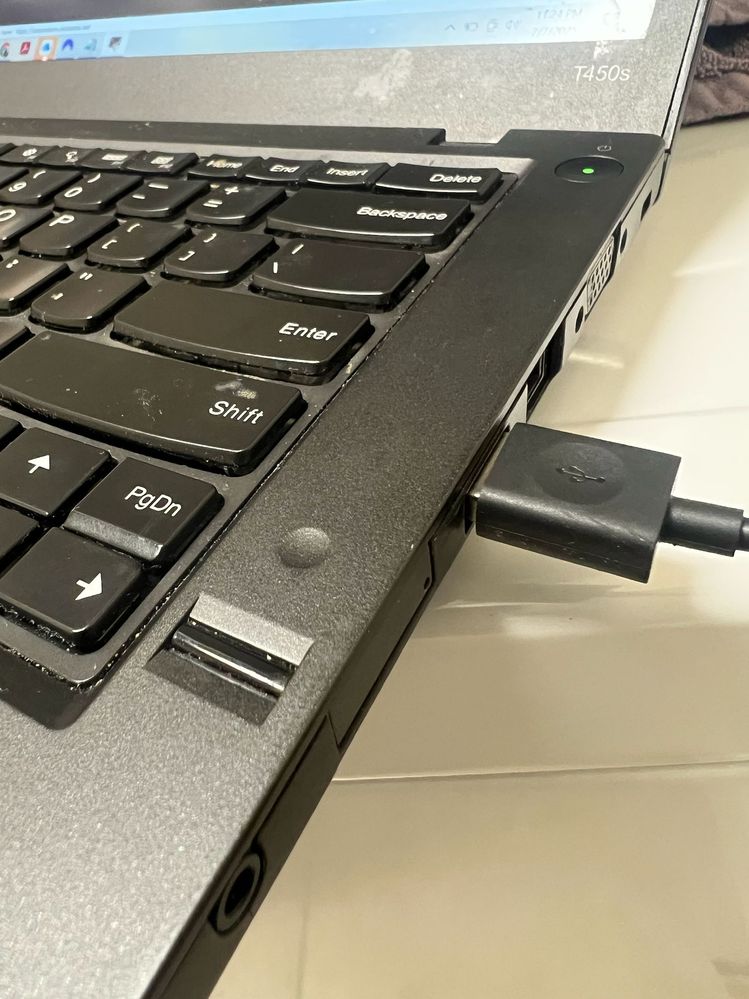

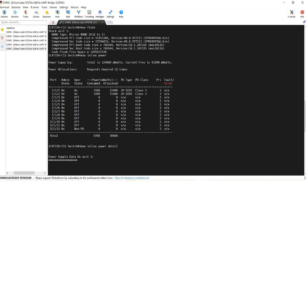

I followed the steps (1) Performed Factory Reset (2) Launched MobaXterm. Here are the results -
Reset completed successfully as mentioned in the link.

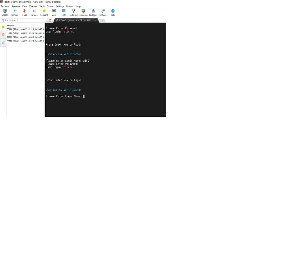

When I launched MobaXterm, It is prompting me for Login credentials. I do not know the login credentials. Please see the images below.
During ResetDuring ResetSuccessful Reset and USB connection to RuckusSuccessful Reset and USB connection to RuckusMobaXterm Terminal screen prompting for PasswordMobaXterm Terminal screen prompting for PasswordLaptop USB ConnectionLaptop USB Connection

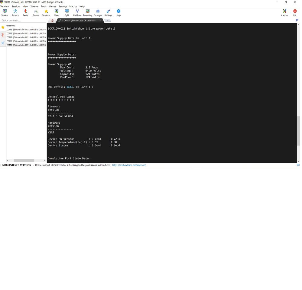

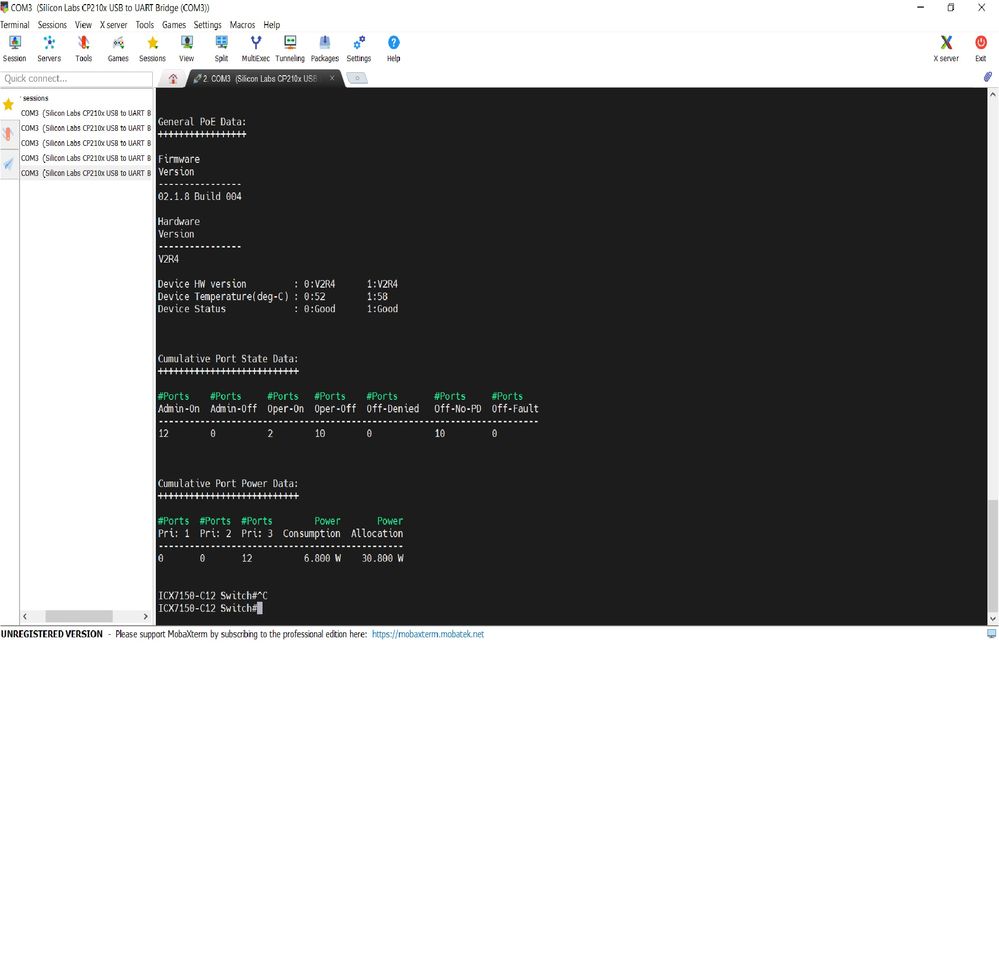

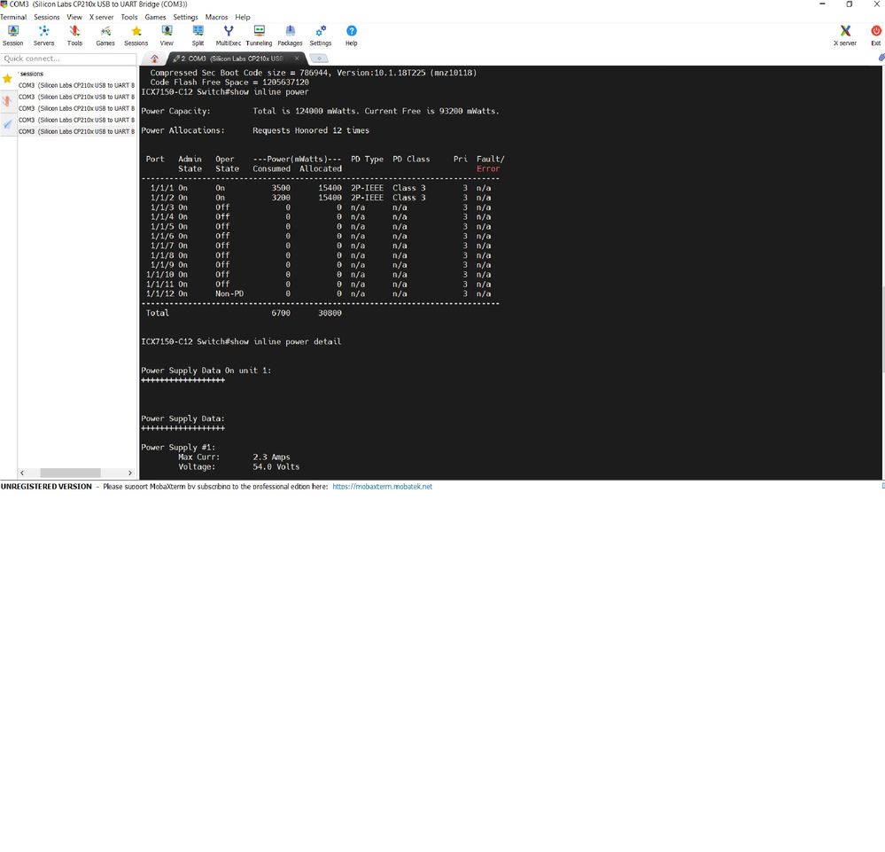

I reset the password using "super" login,Enable and Show Version OutputEnable and Show Version OutputShow Flash OutputShow Flash OutputShow inline Power OutputShow inline Power OutputShow inline Power Details_1 outputShow inline Power Details_1 outputShow inline Power Details_2 outputShow inline Power Details_2 output and please see the output for the following commands.
Please review my latest updates on the output shared for those commands and let me know the next steps.

Hello @VinayGudur ,
Please try connecting the AP to one of the other 12 ports on the switch to rule out a port-specific issue. Additionally, test with a different Ethernet cable to eliminate the possibility of a faulty cable.
Please let us know if you are able to connect to the internet after trying these steps.
