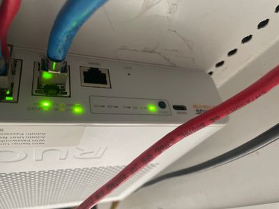

I have a home built by lennar and the ruckus network no longer works. The lights on the extenders are all completely off and I cannot figure out what is wrong with the system. The main ruckus device has power and lights on the Ethernet ports, but I cannot connect to any ruckus extenders.
Can someone help me troubleshoot this? Thanks

Update: the lights stopped blinking but stayed green on pwr and amber on syst.
J9
Okay, we have green lights now! What do I do from here? I want to just reset all the access points and set this up from scratch
J9
Here are the lights on the access points
J9
Now the aps look like this

Hi @J9
As I can see from the pictures you shared, now the lights are back to normal.
I see from a picture you shared, that that there is an ethernet cable plugged into the wrong port. Cables from ISP (Internet Service Provider) Router or any device must be plugged into any 1 in-12 ports as highlighted in the below screenshots. Once you plug it into the correct port reboot (unplug and plug from the power outlet) your RUCKUS ICX-7150-C12P Switch and check the Access Point’s Internet connectivity after some time.
